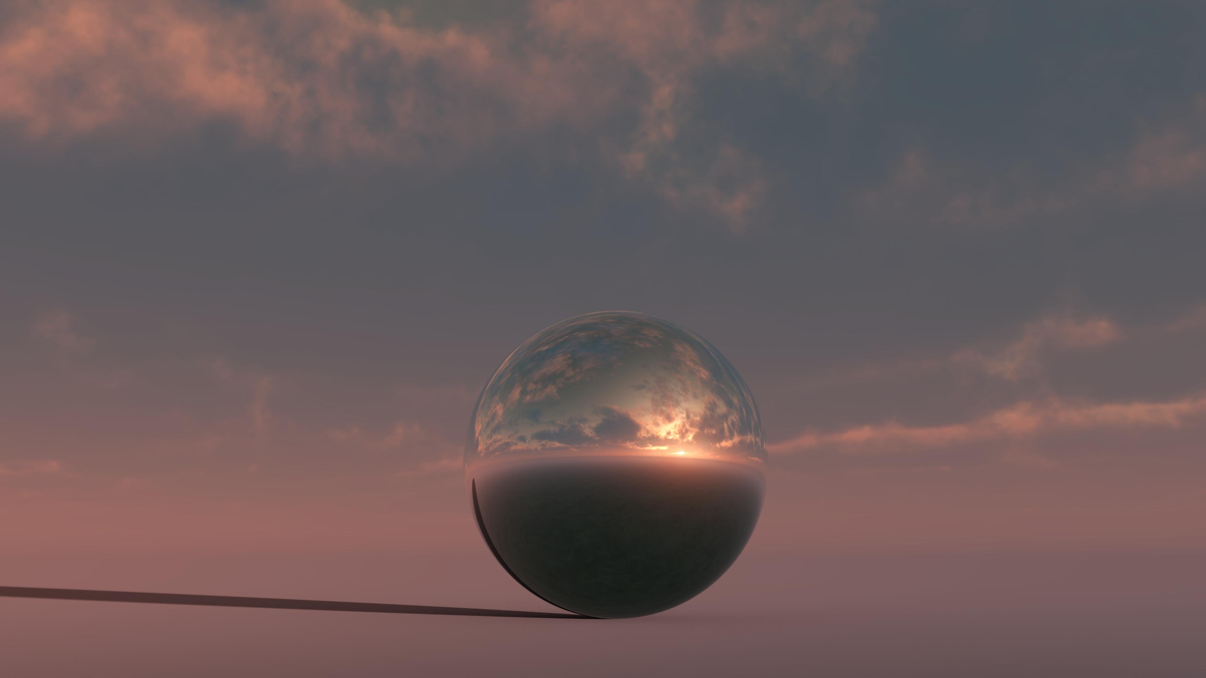

    This is a quick render in 4K using Skies of Economy 16 (I also attached my scene file)
    JPG High Compression (Low Quality)
    JPG Low Compression (High Quality)
    3840 x 2160 - 246K
    duf
    duf
    HDRI_ExampleMirrorSphere.duf
    34K
    3840 x 2160 - 2M
    Post edited by markusmatern on
  • GordigGordig Posts: 10,616
    Probably not an ideal example because it looks like it has a lot of JPG compression.
    You are right, I uploaded a HQ version
