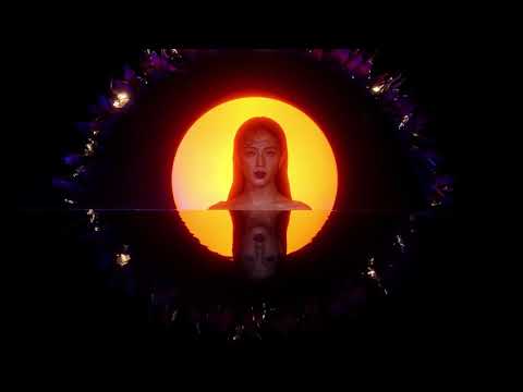

Create a dark sky with a yellow sun
I had a brief time with Daz couple of months ago, haven't had enough time since then but recently I cleared most of my schedule.
With extra time in my hands I want to recreate the image I attached; yellow-orange sun under a dark sky with a floor of water under the figure.
Any tip or input to the right direction is appreciate C:
  • I want to recreate the image I attached; yellow-orange sun under a dark sky with a floor of water under the figure(figure is gonna be half body instead of the head shot).
    Any tip or input to the right direction is appreciated C:
    1341 x 1025 - 1M
  • 3Diva3Diva Posts: 12,017
    You could use a primitive plane with a water shader for the flat water reflection effect (or you could even try a metal shader).
    You could use a primitive sphere as the sun/moon behind her. Turn Emissive on (in the Surfaces Tab) and adjust the emissive settings and color until you get the brightness and color that you want.
    Use Crush Blacks and Burn Highlights in the Render Settings >> Tone Mapping Tab to get the desired contrast that you like.
    You could lower the Environment Intensity to make it a bit darker.
    Turn on Bloom in Render Settings >> Filtering (you'll need to adjust it).
    Other than that it will be some trial and error - make some adjustments, do a test render, rinse and repeat until you've found the look you're after.
  • SevrinSevrin Posts: 6,313
    Way easier to composite than to try to recreate in DS.  In the video, there's one kind of lighting on her, and another kind in the reflection.  I'd do one render of the background sun, which turns out fine with the bloom filter, and then another of the character and water.  Adjust colours for the character in post.  The ripples on the water would probably also be easier than in post if you want sharp reflections on ripples.
