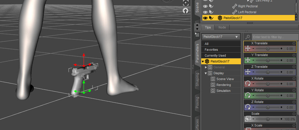

    @NorthOf45
    Thank you, a quick question in return: When I import the pistol into DAZ, it looks just like this. Looks perfectly fine, doesn't it?
    So I don't know if your explanations are really suited for my situation:

    Okay, that looks good. But how did the pistol get up and behind the figure's head in the first picture? If you parent the pistol to the hand, it should move to the hand, aligning the Center points (pistol and hand bone). Might not be pointing in the right direction, though.
    Anyway, to answer the question, I don't think there is a way to display the pistol's position relative to the hand since it is not part of the figure's skeleton. The Transforms shown are the position relative to its loaded zero position, after parenting and adjusting, but don't change as the figure is posed. The hand's transforms will be its position relative to its parent bone (forearm). The coordinate system used in the Parameters tab can't be changed (probably too confusing, I know I am getting dizzy playing with the different modes.)
  • The pistol got behind the figures head after I parented it to the rHand and then set the pistol's position to (0,0,0).
    I was hoping this would place it at local position (0,0,0).
    Obviously it doesn't. But that's not so much of a problem. Having the rotation ok is sufficient now for me to test the pistol aiming.
