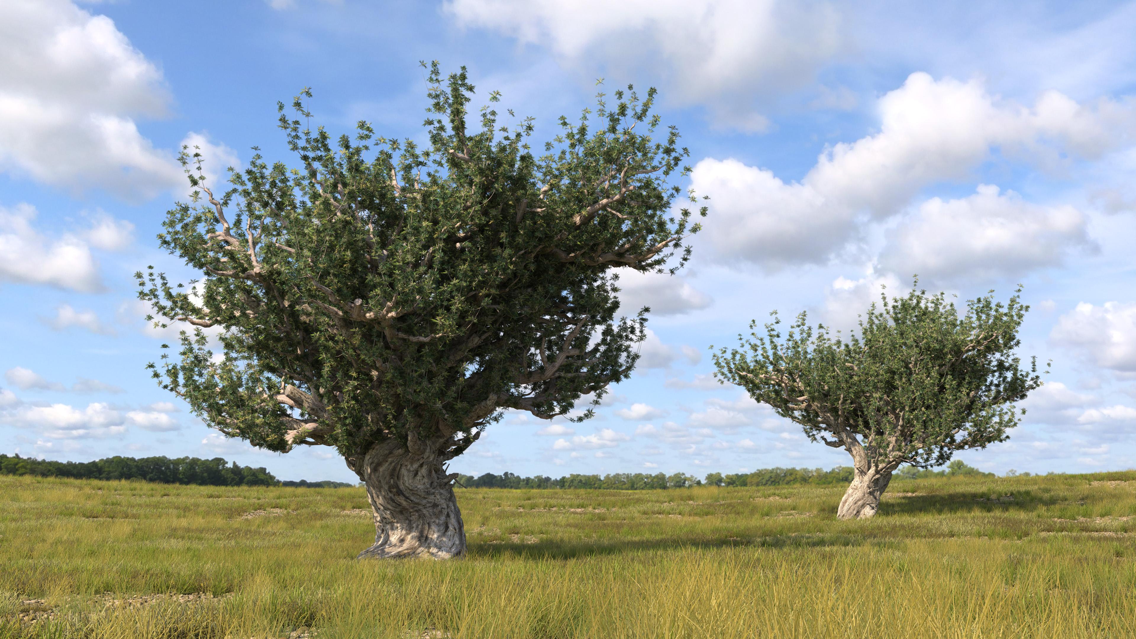

    I created a pretty flat UltraScene terrain with a slightly modified Grasslands ecology. Then I manually added a couple of the new olive trees. They look pretty nice. They are very large (larger than the large oak trees I found one of the oak trees that is about the same size). The wide bottom of the trunk will not work well on sloped terrain. I learned that lesson when trying to adapt Willow Creek trees to UltraScenery.
    USC Grasslands BV Olive Tree Sunflowers HDRI Default Camera (3840 x 2160).jpg
    3840 x 2160 - 3M

  • dawnbladedawnblade Posts: 1,723
    These are beautiful trees.
