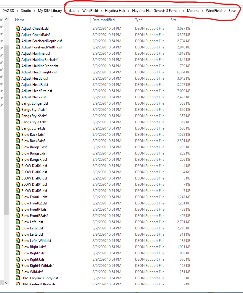

It sure looks like the shaping presets got installed, but the morphs that those presets use, did not get installed (or did not get installed correcty to the right place, or Daz Studio isn't looking in the right place for them). Let's go look and see if they are installed at all:
Do you have those files? If not, we have to figure out why not. If you do have them, we have to figure out why Daz Studio doesn't see them.

Okay, so I found all of the .dsf files just like they're displayed in your screenshot, I think we're getting somewhere. I've also found the morph preset files that are displayed in my content library, but they're in a different directory (E:\Program Files\DAZ 3D\Applications\Data\DAZ 3D\My DAZ 3D Library\People) than where the actual morph files are (E:\Program Files\DAZ 3D\Applications\Data\DAZ 3D\My DAZ 3D Library\data\WindField etc). I'm not sure if this is what's causing the issue.

So the morphs files are installed and seem to be in the right place.
It is correct for the presets to be in the People folder (People\Genesis 8 Female\Hair\WF Haydina Hair\Presets) and the morphs to be in the Data folder. So that is not the issue. Since you can see the presets and the material presets even work, it seems like your content library is properly mapped in Daz Studio. This is a puzzle!

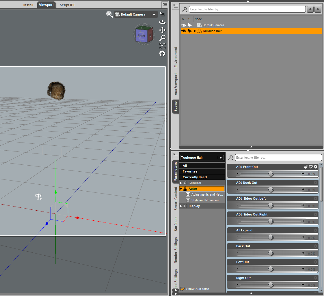

Let's see if it is only Haydina hair that is the problem or if it is a broader problem. If you load the Toulouse Hair from Genesis Starter Essentials, do those morph show up in the Parameters pane? They would be in the Actor section.

Yup, they do.
