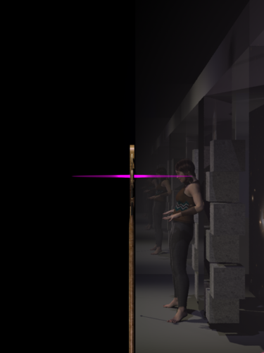

    Do the "Artificial Reflections" suffer from that? The attached pic is purely "Ray-trace" on all lights, with surface reflection properties set to mimic mirrors and polished surfaces with actual refection to an extent. I'm Still very new to this. It was a 3Dlight crunch test of sorts, for this lacking computer.
    Render settings for the pic from what I can remember, and notes from the test.
    Bucket Size 16, MaxRayTraceDepth 5, PixelSamples (X) 4,PixelSamples (Y) 4, SadowSamples 16
    Gain 1.00, Gamma Correction 'Off', Gamma 1.00
    Shading Rate (per Image test, 1.00 or 2.00 from the looks of it, I don't remember for this pic)
    PixelFilter 'Sinc', PixelFilterWidth (X) 6.00, PixelFilterWidth (X) 6.00
    1200 x 1600 - 1M

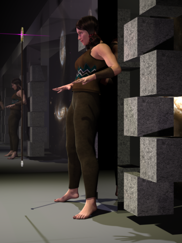

    After getting a night of good sleep, and mulling over the settings I have tried and reviewing the invaluable advice from Jaderail, chohole, Sean Riesch, Richard Haseltine, Miss B, mark128, mjc1016, DestinysGarden, etc.
    The clarity of a real reflection is affected by the 'Difuse' and 'Reflectivity' setting of the surface doing the reflection to an extent. However when it comes down to the limited access we have to the vast array of 3Dlight capabilities bundled with Daz Studio, we only have two basic setting that make real reflections look good.
    Render Rate (with numbers smaller then 0.20), and 'Max Ray Trace Depth' of 4 minimum for skin edges in the reflection.
    The more Diffuse the surface is that is reflecting, the more 'render rate' samples are needed to get an accurate per pixel result (in other wards a lower number in the 'render rate' setting box). I have seen some formulas of how this effects crunch-time, tho I have not found an actual list of 3Dlight compatible numbers for this setting beyond 2.00, 1.00, 0.50, 0.20, 0.10 and 0.01 as of this typing.
    Max Ray trace depth, somehow is affected by the number of layers and other stuff that make up skin texture on figures. I assume this applies to hair as well, tho I immediately noticed the rugged outline of my render's shoulder reflections most prominently. When I set the 'Max Ray Trace Depth' to five from four, it made a small improvement for some reason I don’t fully understand.
    The attached render was at 5 'Max Ray Trace Depth', and 0.10 Render Rate. Render time was 35 min 43 sec, with nothing else running on this computer.
    1200 x 1600 - 2M

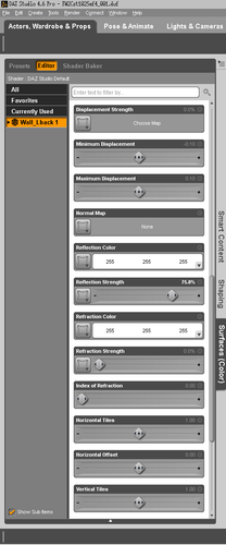

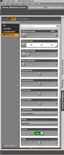

    That was confusing for me at first, as there is two separate reflection sliders in the surface properties tab. 'Glosiness' need not be touched, levee it at 100%, and 'Reflection Strength' further down needs to be turned up (90%).
    Also, if the 'Diffuse Color' color is to bright, the reflections wont show.
    P.S. Doing this on two separate comps for the rest of the month, daz Studio is on the other. Tunes and web over here, lol.
    The pillar behind the figure in that pic is set to pure black on the 'Diffuse Color'.
    "O", and if the 'Lighting Model' further down is set to 'Mat' or 'Skin' the reflections will be very dull if not there at all. I used 'Glossy Plastic' for my renders.

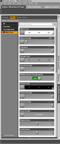

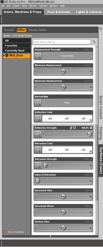

    O.K, back pillar and the side wall. That should help out a bit, as I was mistaken a bit earlier. Back Pillar Settings.
    500 x 1200 - 52K
    500 x 1200 - 53K
    500 x 1200 - 55K
    Side Wall Settings.
    500 x 1200 - 54K
    500 x 1200 - 52K
    500 x 1200 - 55K

    Oh that's interesting, Diffuse down to 0%. And then with but a moments thought perhaps it makes sense, if the surface cannot diffuse any light then it is left with no option but to reflect as per other settings. Is that right, he asked uncertainly.
    I guess, not completely Shure my self. Tho they both Diffuse + Reflective strength add to 100%
