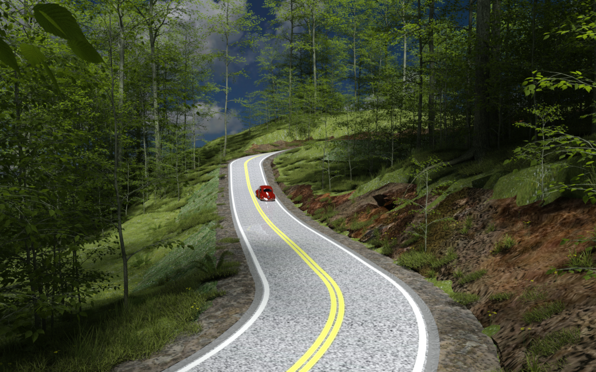

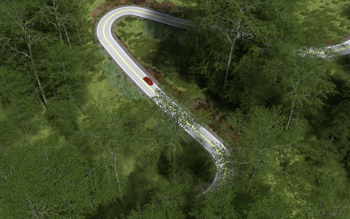

    Finally had some success putting a paved road into Ultrascenery. I started with a terrain and road with its cut and fill. I  created a height map of it using AoA's Distance camera. I created a no feature Ultrascenery scene using the height map then used a mask of the road/cut/fill to keep most of the vegetation off. Took a little tuning to get my terrain to match up with the Ultrascenery base which I then turned off after copying it's default texture to my terrain. I've tried this a few times and this is the first time I am reasonably happy with the results. It was enabled by having the masking feature available, some tips from Barbult's experiment thread, and tips from this thread. So helpful to have a community sharing what they learn.
    Added a more distant view:
    1200 x 750 - 2M
    1200 x 750 - 2M

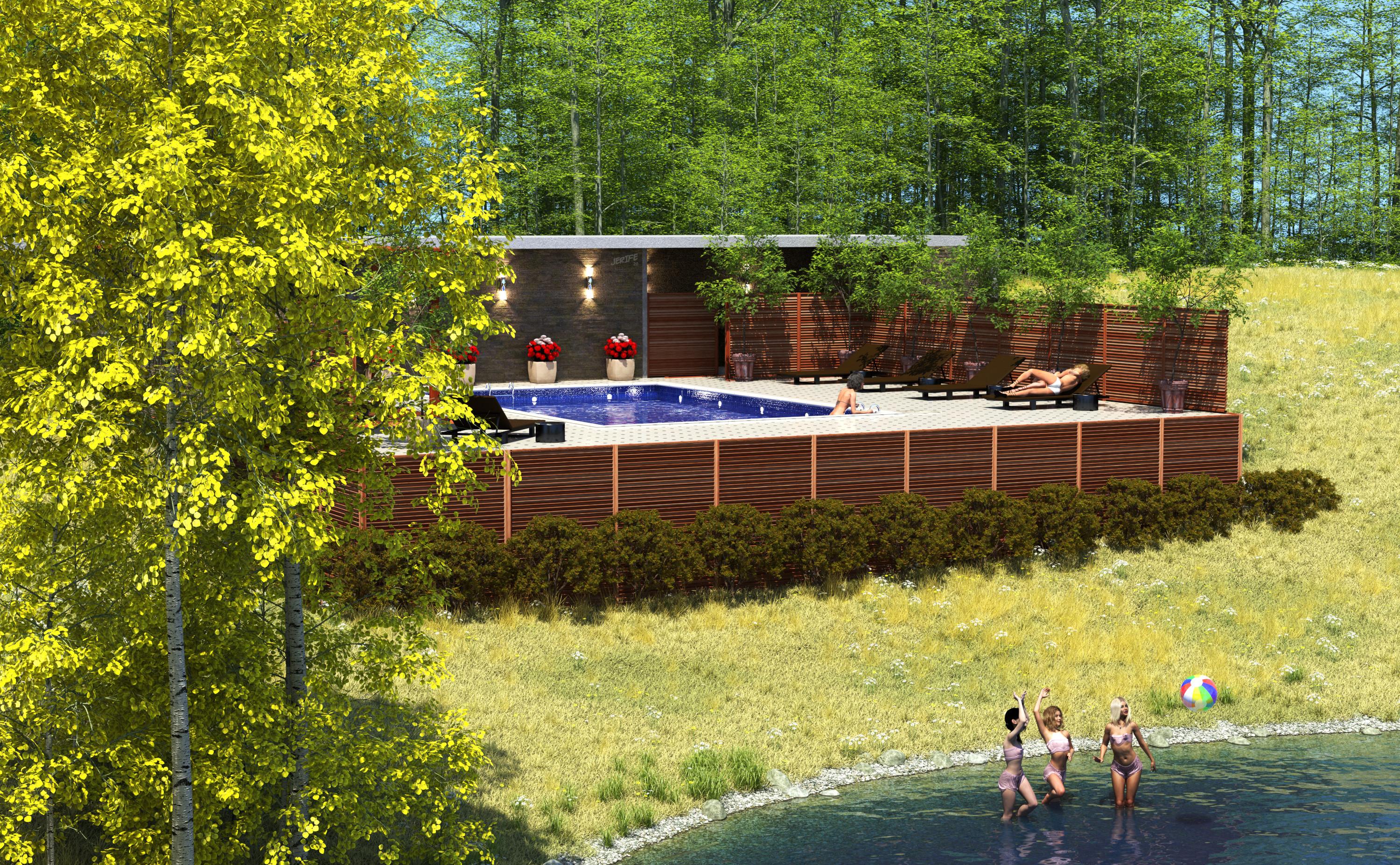

  • JerifeJerife Posts: 272
    edited July 2020
    Almost here!
    I reached page 62; Excellent product, excellent thread, thanks to you all
    Now I know what masks are and how to use them as well as inverted height effects but all theoretically as my machine was finishing my first experiment
    And here it is the final result
    Sedor's Outdoor pool https://www.daz3d.com/outdoor-pool-and-poses-for-victoria-8-and-michael-8, 2 ultascenery one with the pond tweaked to have a swimming pool, other one in the background, sun and sky in July at 11:30 at 40ºN,
    6 GF8, lots of duplicated UltraTrees in pots or in a hedge (I don't know how to work creating instances, I duplicate nodes instead; can anybody point me where to learn the instances basics?) and bunchs of carnations scaled to big dhalias from Xfrog plants. A day and two nights rendering (I was afk) and a couple of partial renders to correct some things of the final render
    And of course following the advice of this great Australian man from Carrara forums whose name I can't remember who always spoke about levels, levels, levels in postrender done in this case with The Gimp
    Thanks again to you all for every tips and pieces of advice
    Aplying the masks first and doing the hole in the mesh afterwards allowed me to create terrain with less height (3.5) rendering the stairs unnecessary as my building went from +3 to -230 in the Y axis

  • barbultbarbult Posts: 26,542
    @RGcincy I especially like the top down view that you added. I didn't understand why you created a separate terrain and deleted the UltraScenery terrain, though. Was that because the road was part of your terrain?

  • RGcincyRGcincy Posts: 2,862
    @barbult I've been writing a road building program that creates a road, curb, shoulder, and cut and fill merged into a base terrain. The distance map of all that is a close match but not perfect so the Ultrascenery terrain penetrates in and out of the road elements. Just easiest to hide the Ultrascenery terrain after it's gotten the plants into a position that works well with my terrain. After I get more familiar with working with both, I may learn to do it differently.
