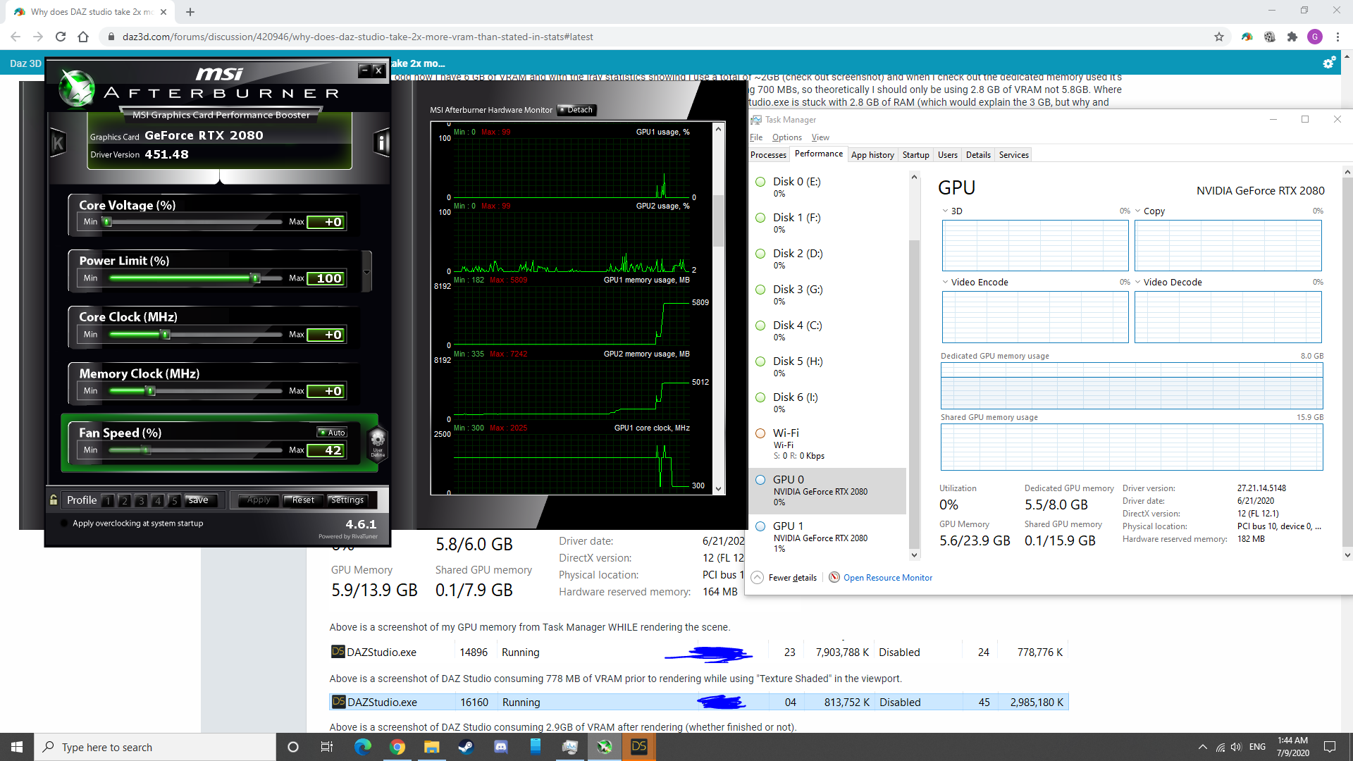

I find this a bit odd how I have 6 GB of VRAM and with the Iray statistics showing I use a total of ~2GB (check out screenshot) and when I check out the dedicated memory used it's 5.8GB/6 all from DAZ Studio. While I'm editing the scene using Texture Shader, I sit around using 700 MBs, so theoretically I should only be using 2.8 GB of VRAM not 5.8GB. Where are the 3 GB's coming from? Also, I noticed that after rendering (whether finished or not), DAZStudio.exe is stuck with 2.8 GB of RAM (which would explain the 3 GB, but why and where?) and it stays there whether I create a new scene, purge memory, it stays unless I close the application. I am currently using DAZ Studio 4.12.1.118 Pro.
Screenshot of Iray while rendering ~2GB of memory consumption
Above is the screenshot of a scene using an estimate of 2 GB  of memory consumption.
Above is the GPU memory usage WHILE rendering scene.
Above is a screenshot of my GPU memory from Task Manager WHILE rendering the scene.
Above is a screenshot of DAZ Studio consuming 778 MB of VRAM prior to rendering using Texture Shaded (for viewport).
Above is a screenshot of DAZ Studio consuming 778 MB of VRAM prior to rendering while using "Texture Shaded" in the viewport.
Above is the screenshot of DAZ Studio stuck with 2.9 GB of VRAM after rendering image.
Above is a screenshot of DAZ Studio consuming 2.9GB of VRAM after rendering (whether finished or not).

    but here's what I'm seeing from monitoring whats actually going on.
    Oh, btw, this render ended up failing with an error when the denoiser kicked in.
    1920 x 1080 - 369K
