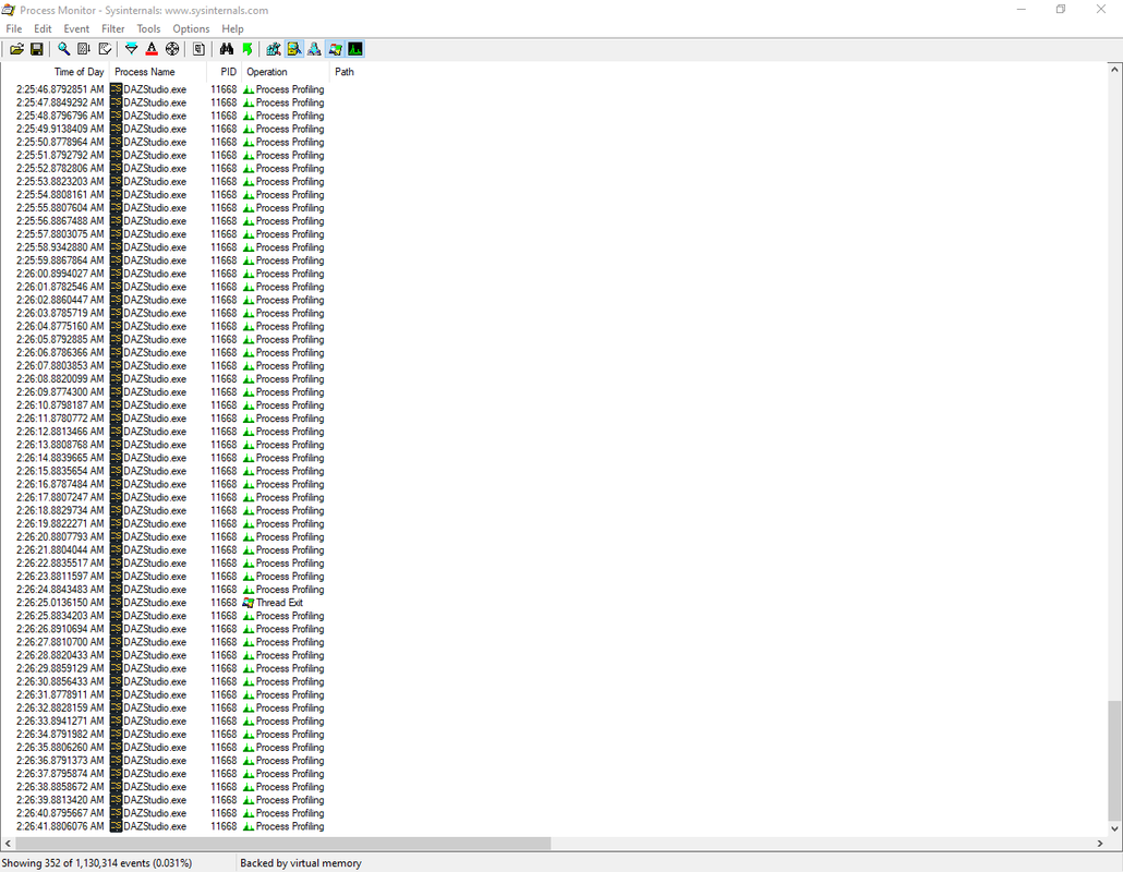

    I use Configurtion Manager Trace Log Tool from microsoft. Here an example of G8 loading error I get and have no clue how to fix.
    2020-07-05 09:40:47.297 WARNING: ..\..\..\..\..\src\sdksource\fileinput\dzassetdaz.cpp(6681): Could not find target property for formula: Genesis8Female:/data/DAZ%203D/Genesis%208/Female/Morphs/DAZ%203D/Victoria%207/FBMVictoria7.dsf#FBMVictoria7_v1?value in file : /data/DAZ%203D/Genesis%208/Female/Morphs/Xameva_and_Meipe/XandM_UltimateBreastMorphs/XandM_V7_ShoulderCor2_R.dsf
    I know it's XanM Ultimate Breast Morphs but this is suppose to be a Genesis 3 item why is is coming up as an error for Genesis 8 I have no clue. I also see the Auto Face Enhancer coming up as an error so I removed it from my Daz. I liked AFE but I didn't use it often so I'm not going to bother with it right now.

    I guess the only good thing I really got out of this is the Duplicate error is gone now.
    Thanks for all your help guys it was really useful.
  • Richard HaseltineRichard Haseltine Posts: 108,526
    RD2ART said:
    What I meant was that the poses process all the morphs. So the more files in the data folder the more time it takes to process the pose. Try this out by removing all morph folders except the Genesis 8 morph folder. Your pose should process quicker. Perious Generations seem not to have the problem as much as Genesis 8. I discovered this when I installed a fresh copy of DAZ3D. All my poses went quick. But as I added characters in the DIM the slower the poses went.
    Applying poses does require Daz Studio to check through for JCMs, morphs triggered by the joint in question. It isn't reading files (unless a previously zero morph becomes non-zero and so it needs to load the deltas) but of course reducing the number of fiels reduces the number of morphs to check.
    Fiels? or Fields?
  • TBorNotTBorNot Posts: 375
    edited July 2020
    Exit the program, delete the log file, try it again.
    I believe the computer is indeed not doing anything, at least not in Daz3D.  The log file lines are available as the program runs, which means the file is being opened, written, and then closed.  This works pretty well, until eventually, you create a file that overwhelms the disk output buffer, and then kaboom!  The operating system goes into confusion mode, essentially dumping everything and restarting after every log write.  Older systems, which had slow I/O devices, would leave the file open to avoid this, but I think we have become lazy.
    Post edited by TBorNot on
    Files, sorry
  • Ok, I've been playing around with the custom save pose problem for a while now and the only thing that seems to work for me is posing the G8 character before applying clothes. Since I've been going through this I've seem my pose would go from 10 minutes to as long as 90 mintues for a character to pose.
    Like I said before this doesn't happen when I use poses from the content library or anything bought it only happens after I've saved it to a personal folder. Any pose I make will take forever to load. Another thing I notice is the same pose loaded on G3 won't have the load times as on G8 also the G3 custom pose doesn't have the load times when applied to a G8 character (I think I mentioned that earlier).
    But when I have a naked G8 model and I apply the pose it would take about 3 to 10 minutes at most to load now. I guess this is the only work around beside removing all my Morphs.
    Did a little digging because I have noticed my own pose files taking longer to load than some premade ones, and I think I found the cause...
    When the pose is saved, I usually just check that I'm saving the current frame, but if you expand the character and start looking... It is saving a lot of stuff related to installed content, which I think quite a lot could be discarded.
  • Yeah it took me a while to notice that too. I started using the little box in the pose save popup.
    There's a little box under End Frame: In that box I just pick [check all modified] and [check all transforms].
    When I go down to properties I open the character properties and I uncheck [General] because I hate when I apply a pose and it moves my character to the location it was saved in the world or change the scale of my character to the scale the character was save in the pose.
    That little box is very important but it's not even labeled!
