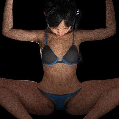

  • I add the evidence.
    Scene : includes 6 spot lights for the Genesis8 face.
        (scene includs one Genesis8 Female and 6 spot lights )
    Camera : Headlamp Mode is off.
    Render Setting : Default, Auto Headlamp is Never.
    1. Render Setting Environment Mode changed to Sean Only.
    The result as ...
    Her face illuminated by spot lights in the scene, good.
    2. Same scene, same camera,
    only Render Setting Environment Mode changed to Dome Only.
    The result as ..
    Her right side shoulder and west illuminated by IBL, good.
    3. Same scene, same camera,
    only Render Setting Environment Mode changed to Dome and Scene.
    The result as ..
    Her face looks like more brite as Scene Only case, good.
    Her right side shoulder looks like more brite as Dome Only case, good.
    But, her right side west looks like more dark than Dome Only case, why?
    I can not understand it.
    The Dome and Scene case is always bright than Dome only case,
    isn't it ?
    What is the dark matter in my scene ?
    Can anybody tell me why the phenomenon occurs ?

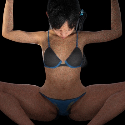

  • Richard HaseltineRichard Haseltine Posts: 108,996
    I just set up a really simple scene - default Genesis 8 Female with Basic Wear sitting on a cube using one of the default poses, with a 6,000 lumen spotllight shining at her face. I then did three renders - Dome Only, Scene Only, and Dome and Scene. In my image editor I loaded the Dome and Scene one first, then added the other two as layers on top and grouped them. Setting the top layer in the group to Screen blending mode and the group to Difference should give a pure black image, if the two separate renders combine to give an exact match for the render using both light sources, but in fact they don't - adding a levels adjustment layer on top it is clear that there is a noticeable difference around the face and some difference across the whole render. So I agree that they do not combine as I would expect, but I'm not sure why
    1000 x 1000 - 211K
    1000 x 1000 - 205K
    1000 x 1000 - 75K
    1000 x 1000 - 63K
    1000 x 1000 - 238K
  • I noticed  my misunderstand !
    I thought lights don't block light.
    But it was a misunderstand.
    The spot light whose Light Geometory is Disc,
    it blocks other light, ie, IBL's light.
    I want to know the setting not to block light...
