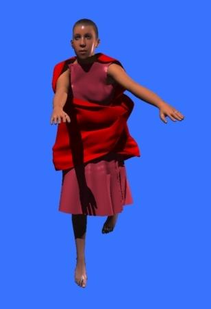

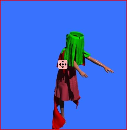

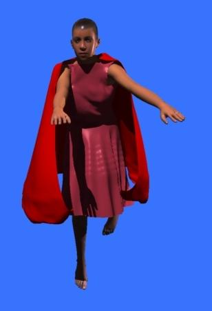

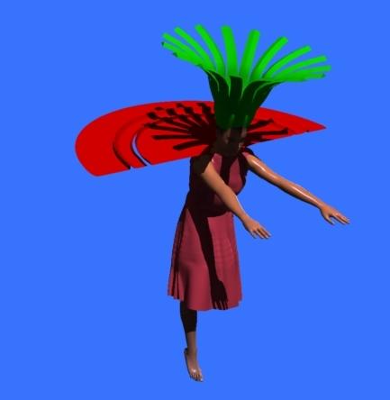

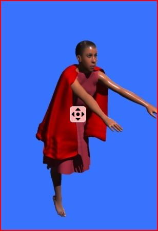

  • Hermit CrabHermit Crab Posts: 876
    Hi all
    What I've done today is:
    1 Removed the skeleton from the rigged figure
    2 Added the dress to the figure and then re-attached the skeleton
    3 Posed the figure with the dress (a silly pose unfortunately)
    4 Exported the dress as an object in the pose
    5 Replaced the poseable dress with the OBJ version. The figure's pose shouldn't be changed.
    6 Turned the OBJ into a soft body object with some pinning at the waist.
    7 Carried out the simulation - now the creases and folds appear.
    8 Export the draped version of the dress as an object. The soft body version is now deleted and replaced with this solid, draped version.
    9 Then I brought in another mesh - which was turned into soft body - to make a cape
    433 x 444 - 41K
    308 x 451 - 34K
    308 x 451 - 32K
    308 x 451 - 31K
    308 x 451 - 35K

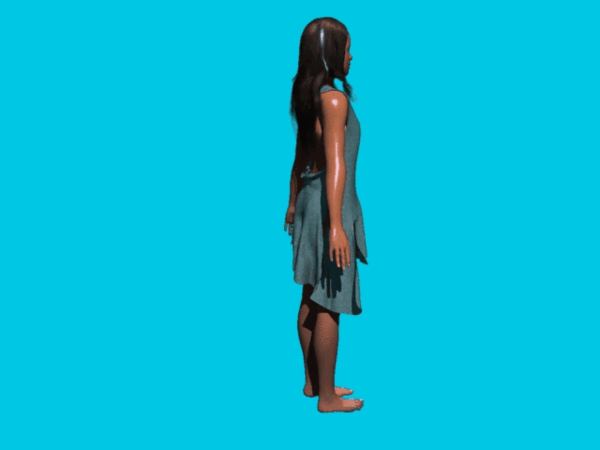

    I've continued to try out 'clothes-building rules' by adjusting the mesh I offered in the dropbox project. (free - and worth what it cost!).
    The gif below shows a tiny glimpse of the 60-80 two-second renders I've done. The clothing is now halter neck, Cinderella style, for want of a better description.
    640 x 480 - 79K
