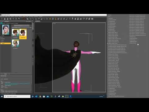

    Question, I need to marry an emblem to the back of a cape. I have gotten as far as the emblem placement but it will not parent to the BACK of the cape! The parent directory only shows clothing options such as upper chest, lower chest not upper back or lower back. Is their a way to lock the emblem to the cape so when I simulate it or change pose I dont have to do the back emblem every time?
    Is your emblem a 3D object or a 2D logo? In other words is it supposed to be embroidery or an image that was painted or sewn on to the cape?
    If so, maybe you should try adding the image of the emblem to the actual texture of the cape.
    Open the texture Map of the cape.
    1) Select the cape in the SCENE TAB.
    2) Switch to SURFACE TAB and near the top is the DIFFUSE Channel (might be called Base Color)
    3) Hover/Left-click the mouse over the thumbnail icon of the Image being used for the Texture. (it will show you the name and location of the Texture Map - note the name)
    4) Choose BROWSE and navigate the that file and Copy/Paste that file to a new location (usually the folder where I'm keeping the working files)
    MAKE  YOUR OWN VERSION OF THE TEXTURE
    5) Open that file in an image editor and position your emblem on the cape.  Save as PNG or JPEG.
    6) Back in Daz Studio, repeat steps 1 -> 4 and this time BROWSE to the NEW VERSION of the cape texture you just made and saved. Choose it.
    7) Check in Daz Studio to see if the Emblem is where you want it. IfF not, I adjust it and save with a new name, usually like CapeEdit01 then CapeEdit02 until I get it right and then erase the ones I don't need.
    Short Video
    Showing how.
