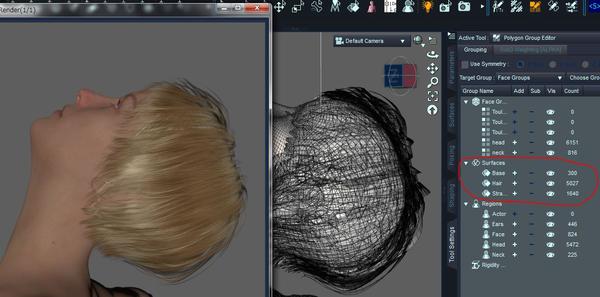

    I tried to reduce poligon counts 25000 to 7000
    about base, manually reduce by roop edge resolve,,(in blender,,)
    then transfer weight and rigs from original,with smooth modifier.(by TU)
    then change scene ID prefered base to genesis2female,
    after that, it can fit to (without auto-fit window) genesis2female
    it seems work well,, ( Blender may better, than meshlab, I beleive hexagon can do
    almost same thing though,)
    about meshlab ^^;
    I could not find correct step to keep UV when decimate,, (there should be way,, though I think,,)
