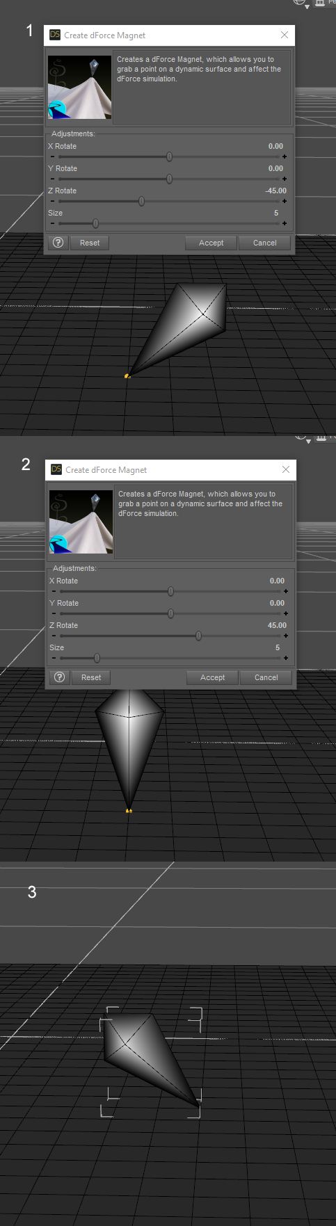

    No problem with crashes using the update, but there is an issue where, after positioning the magnet using the sliders, the position changes when the dForce magnet dialog is closed.
    (Edit) I suspect that the problem is that the saved orientation values are not being added correctly to the calculations for the new value.

  • RiverSoft ArtRiverSoft Art Posts: 6,826
    Can you give me numbers so I can repeat it?  Thanks.
  • galiengalien Posts: 138
    edited May 2020
    I have attached an image showing the behaviour I see.
    The previous time I used the magnet, X and Y rotation were set to zero and Z rotation was set to -45.  When I added a magnet it uses these setting as shown in the top image (1).  I want to change the magnet so that it is perpendicular to the plane, but as soon as I change the Z rotation slider the magnet jumps down to be parallel with the plane so that I have to set it to 45 rather than 0 to move it to the perpendicular position (middle image: 2).  When I click on the "Accept" button, the magnet jumps to a new position which is correct based on the numbers in the dialog, but is not the position it displayed in the viewport before clicking the button (bottom image: 3).
    I hope this helps.

    Ah, I see.  I will look at it, but may not update it right away since the crash behavior has been fixed.  I am updating 8 products right now (all the character converters, Content Wizard, and Now-Crowd Utilities); I don't want to get Daz QA too mad at me laugh

    It is no longer crashing for me. Thank you for updating to fix that. I do see the incorrect orientation behavior that galien reported. I think you shouldn't worry about Daz QA getting mad at you for submitting another update to fix that. They share responsibility for not testing it adequately.
