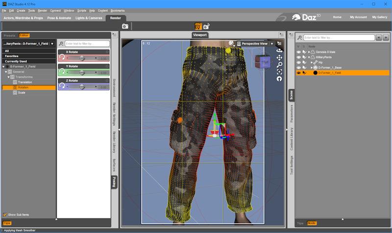

    I don't have the products you're working on, so I've fitted a G8M with the combat pants from Genesis Ultimate Military Basic (still a brilliant product after all these years, btw). I'm going to use a weight map to make one of the pockets bulge out. Here's what we start with:
    Select the pants and create a D-Former (Create > New D-Former...):
    Select the D-Former field, open the Parameters tab, and change its influence from "Sphere" to "Weight Map". The red and yellow dots you usually get will disappear:

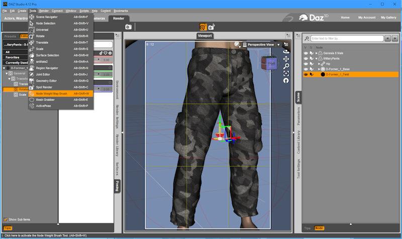

    In the Tools menu, select the Node Weight Map Brush:

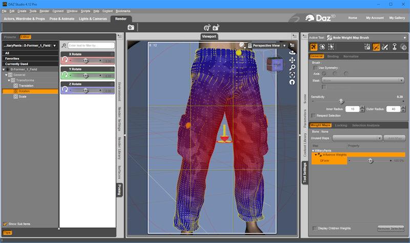

    Still with the D-Former field selected, go to the Tool Options tab and click on "Add Map." A map is generated that has the same strengths as the sphere did. Red is strongly affected, blue less so, and grey not at all:

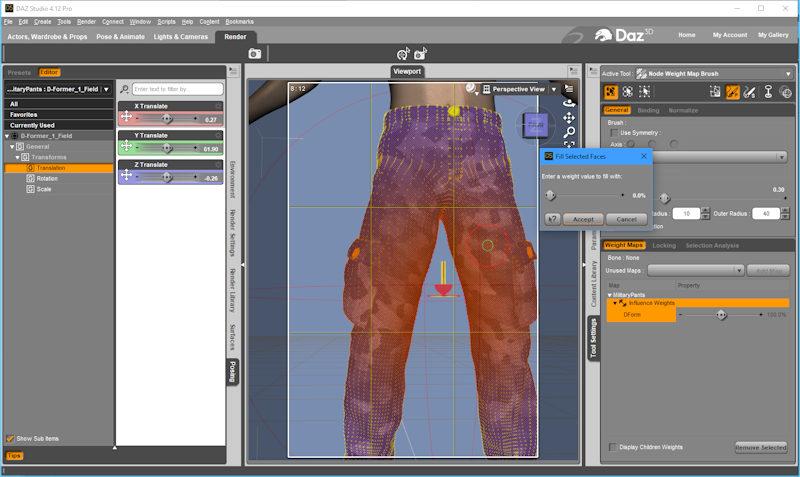

    We want to get rid of this default map, so right-click on the pants and a menu appears that has a lot of the same options as the Geometry Editor does. Choose "Geometry Selection > Select All," then "Weight Editing > Fill Selected..." In the dialog that appears, set the slider to 0% and accept:

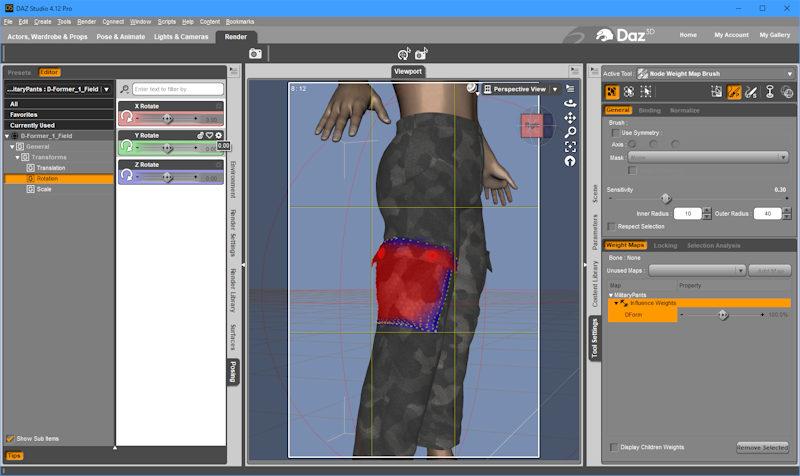

    Now we have a blank grey canvas to work with. Use the brush to paint the area we want to move. I want the front of the pocket to be red, the sides blue, and the rest of the pants grey. It's kinda hard to control the brush with that much prescision, and as you can see, I've splurged over the edges a bit:
    To fix that, hold down the ALT key and use the brush as an eraser (again it works a bit like the Geometry Editor in that respect). The pants leg is now all grey:
    Now we're ready to D-Form! Change back to the Universal Tool, select the D-Former peg thingie and move it sideways. The pocket bulges out, but the pants stay still. Easy, wasn't it?
