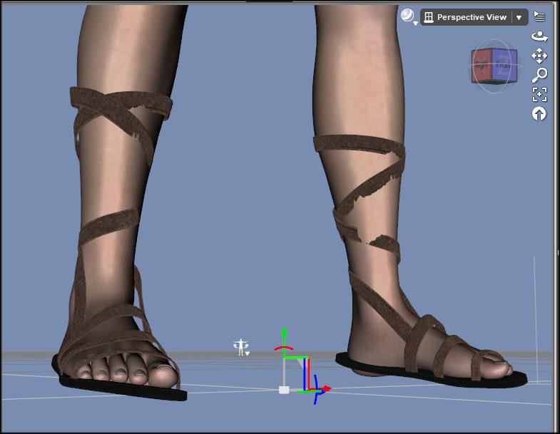

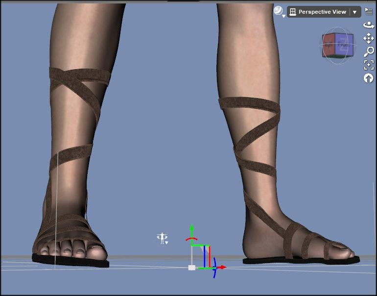

    OK, my render has finished and I've been able to try using the Scene Identification trick to fit some G8M shoes to a G8F. I don't have any elaborate G8M footwear to try out (I'm mainly a G3F and G2M shop), so I tried using the sandals from the dforce Toga Outfit because I figured that the thin straps would really show up any distortion, and be unfogiving of any wrongness in the shape.
    The Scene Identification trick does a horrible job. I guess, if it didn't, Daz wouldn't be able to sell the kit NorthOf45 links to.
    On the plus side, autofitting as a full body G8M item does a great job, with just a little bit of distortion to the soles.
    I guess we've got conditioned by previous generations of autofit clones to expect a specific clone for each type of clothing - footwear, pants, shirt, etc. - and only use the full body one for, well, full body items. But with G8 they've swept away all that. "Full body" now means a normal item that fits to the body (somewhere), that doesn't hang down like long hair or a skirt. They should probably have called it something else.
    785 x 609 - 75K
    770 x 604 - 71K
