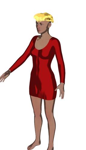

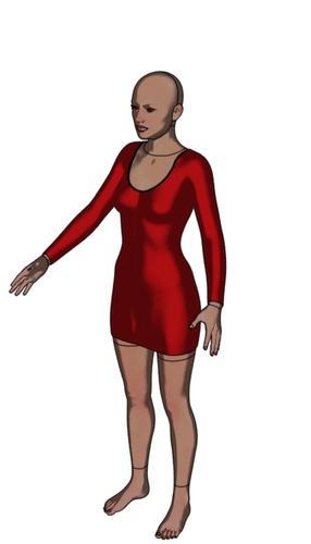

I am having quite a hard time with it as some of the hairs that I have on my libraty hava a SXULL CAP... and when I render it the skull cap that is transparent actually gets outlined
is that a way to fix it?
one is rendered using the normal cam and the other is rendered using the toony cam pro...
any suggestions on how to fix it?

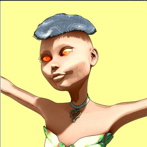

  • CrescentCrescent Posts: 333
    Which camera Outline Style settings did you use? I found that if I use the "Depth On" setting, I get the outline from the scalp. Even setting the Outline ID Color of the scalp to the same as the skin, the outline still showed.
    I found a different workaround, though. If I set the Outline Depth for the scalp to Off in the Surface Palette, the line goes away.
    477 x 666 - 37K
