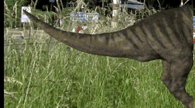

I think I don't understand the question.
That's why I tried to re-create the scene.
Putting the character in the right half of the screen can't be the problem, right? (pic 1)
In my video editing software I can scale and transform both clips where I want them to be.

I have an image of what I'm talking about 1 rendering and 1 rendered on clip.
If you want your character to move from right to left, you nust render the whole animal of course.
If not: I'm pretty sure that in Vegas you can also move your animation in the position you want, just what I did in my example picture.
