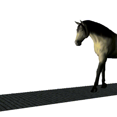

Don't know if I fully understand your question.
I created an aniblock (one walkcycle) and enlarged it.
I couldn't keyframe Mil Big Cat's base at both the beginning and the end, but I then keyframed the Mil BigCat's hip in stead.

Two keyframes: one at the beginning, one at the end. (obviously)
... and that's it.

On the Timeline, put a keyframe at frame 0, move the horse over your translation axis
and put another keyframe at the end of the Timeline. (Frame 128)
Try the other one. The one that says Z-axis and you don't even have to keyframe.
It doesn't come easier...

Have you tried this:....?
(I created an Aniblock from the walkcycle you see in my previous posts.)
after double-clicking on the Aniblock:
- 1: set the slider at frame 0, click the key icon with the + sign. (I forgot to mark that)
- 2: set the slider at the end, translate the horse on the axis, click again on the +key icon.
- and click play. That's all I did.
And That is a cool tip. I always added the Z translate to a Sublevel of the Aniblock on the HIP. but this is so much faster. TY.
EDIT: See where it SAYS Base? You have several SUB levels to ADD tweeks to. That is how I edit hands and Arms in AinBlocks. On the Sub levels.
I gave this animated gif the title:
"The One That Had Enough"
