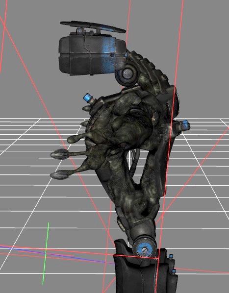

  • nemesis10nemesis10 Posts: 3,830
    edited March 2020
    Here you go,  the green line should line up in profile with the eyes or plane of the face.  Here there is a big robot with one eye so the line aligns with its eye and not its chest.  In your 2.jpg, the green line is a bit ahead of the figure so that the body will be out of focus.
    467 x 598 - 75K
