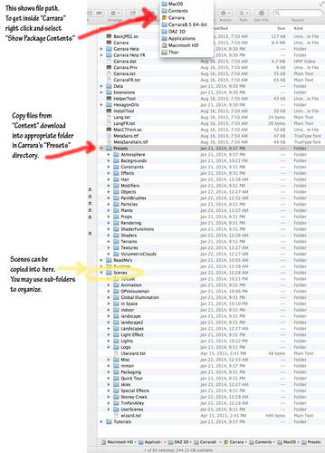

    There was a problem with the original installer, but that had been fixed. When I first downloaded C8.5 on my Mac, I had the same problem. I recently did a full un-install then re-install of everything and DIM put things in the proper place. Note that during this process I removed version 8 from my drive first... Dartanbeck's suggestion that it may be installing to the C8 folder could be the issue in your case.
    Also note that there are a few content packages. Carrara 8.5 Pro Native Content is a 183kb file, Carrara 8.5 native Content is a 3.8MB file. Both of these have little in them. You also need to install Carrara 8 Native content (186.8MB) which has the bulk of the files.
    Regardless, it helps to understand that the Mac install is handled differently than the PC install.
    When you install Carrara, the icon for the program is not the application. It is a "package." This is a fancy name for a folder which acts like a single file. If you are having problems with the native content install, you may want to do a "manual" install.
    Caution is advised - changing things in the "package" could cause problems.
    Go to your Carrara program icon in the Finder. Right-click on it (or Ctrl-click if you only have a 1 button mouse).
    From the contextual menu which appears, select "show package contents." Window contents will show what's in the package.
    From there, navigate to Carrara->Contents->MacOS->Presets
    In the "Presets" folder there are several folders (Atmosphere, Backgrounds, Shaders, etc.) which correspond to the folders in the content file you downloaded. Copy the contents of the _download_ to the appropriate Presets folder in the _package_. If there are also "Scene" files, they can be installed (copied) into the "Scenes" folder one level up (in the MacOS package folder).
    I have included a screen shot which might make it all easier to understand.
    943 x 1312 - 273K
