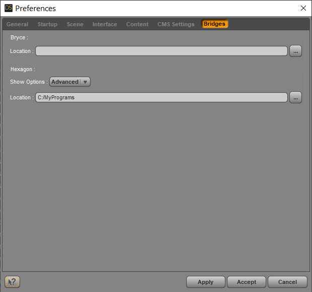

    In D/S - edit > preferences > bridges > Advanced for the Hexagon bridge {gives the most options}
    620 x 579 - 16K
