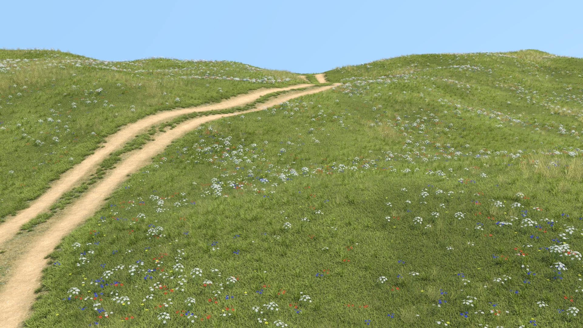

    Inspired by barbult: I used the same daisies but wanted some blue and red, so I changed the json file. smiley
    Edited to add a closer view of the flowers.

    Since setting "Instancing Optimization" to Memory is really important, would you consider just changing it to Memory when the Build button is clicked? That way we don't have to remember to do it. I know I've hit render way too quickly and regretted it.
  • barbultbarbult Posts: 26,487
    I'm happy to be such an inspiration! You're off to a good start. Keep going!

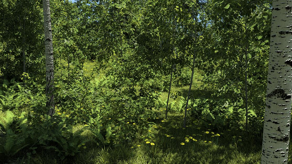

    Here’s my third test scene, using the Ultrascenery product. This one uses one of the buildings out of Faveral's Modular Medieval Village set to provide a little more interest.
    As before, lighting is bog-standard sun sky with a camera in the SS sun node to point the sun.
    This took just over ten minutes to generate and about an hour and a quarter to render.

    The building definitely adds to the scene. Have you tried the render settings preset included in the UltraScenery product yet? I find that to be very good and easier than manually trying to position a sun node. I also like to try out various HDRI files instead, to provide some background. You don't need any additional background in your image. The forest fills the scene very nicely.
