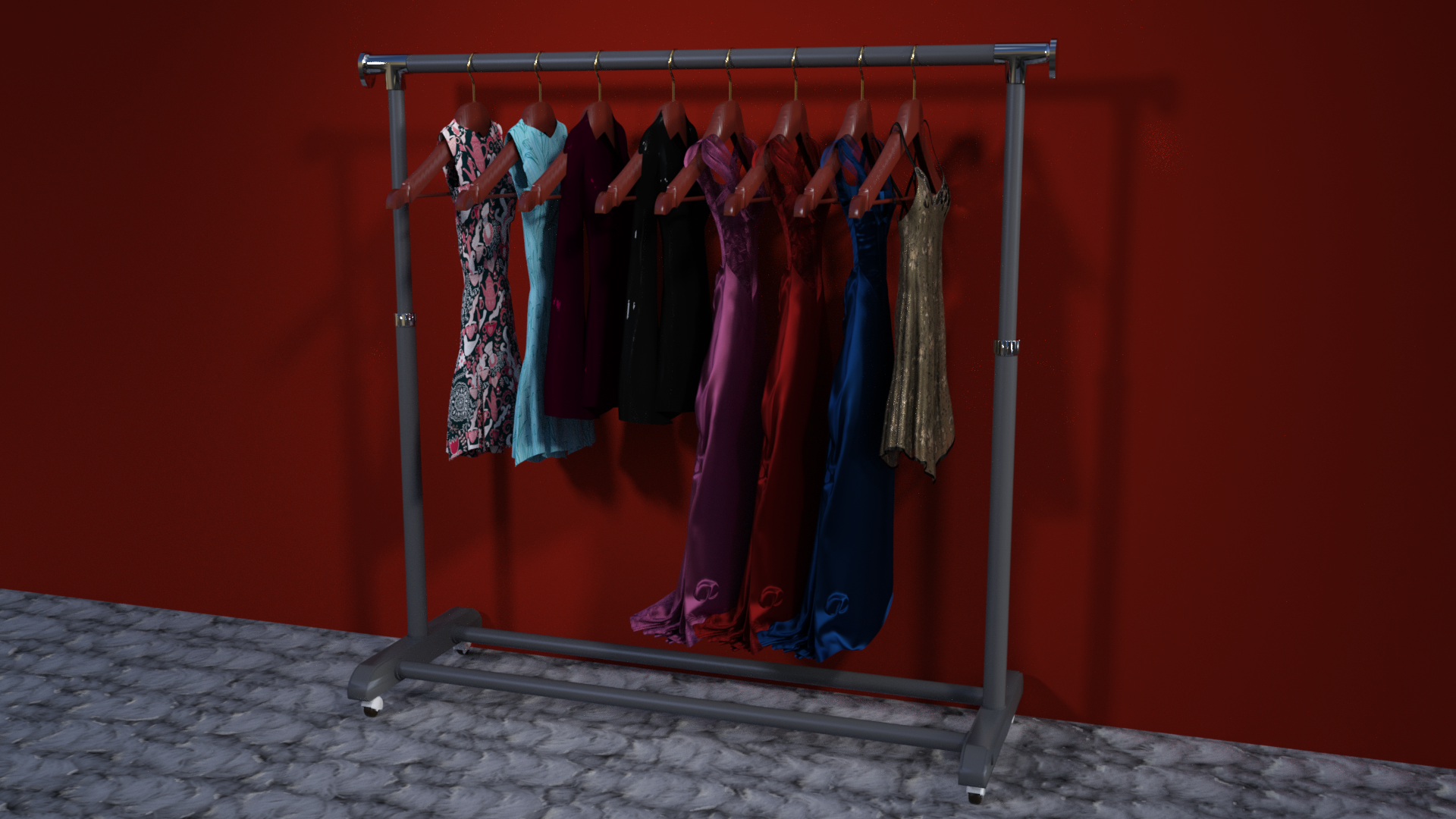

    The method used (putting the clothing on a character and flattening the character on one axis) can be used successfully on any Genesis character.  In this picture, I did exactly that, putting clothing on a G8F charcter then flattening her on one axis, then hiding her, then "hanging" the clothes on hangers.  Works like a charm.  Now I am going to try to use the same trick to create a rack of bikini tops and bottoms.  Should be fun!
    1920 x 1080 - 2M
