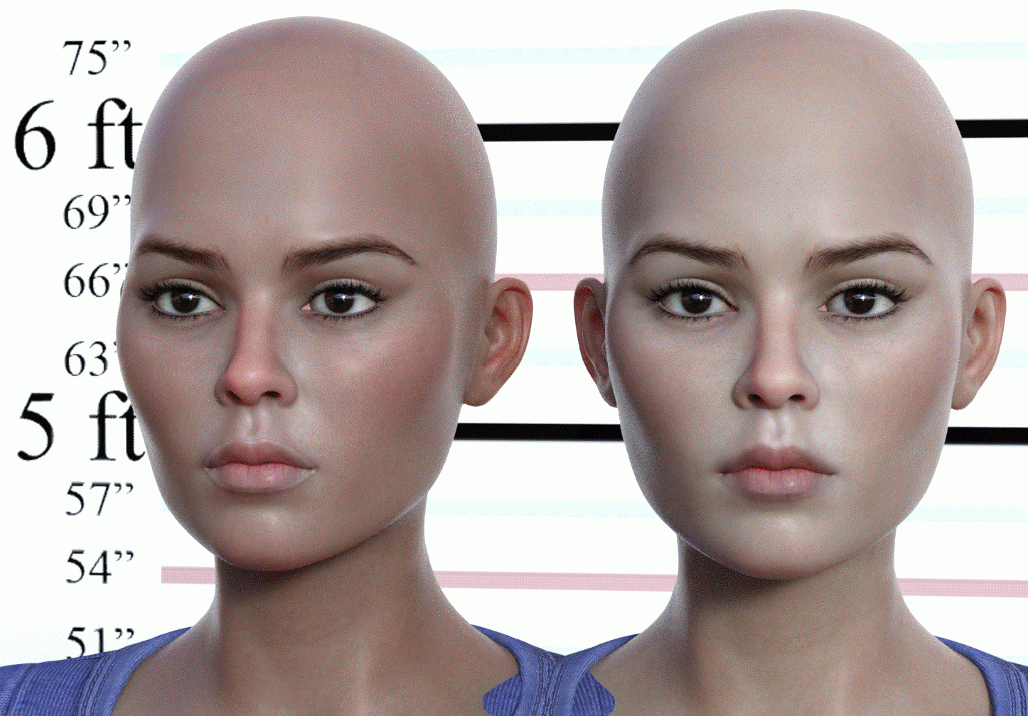

    You can try increasing the saturation of the translucency colour of the face, torso, etc, and then increasing the translucency weight to get a flushed look.  This is Albany with this effect applied to the character on the left.

    @sevrin - Playing with both saturation and transluancy weight is probably too advanced for me at the moment.

    1. Save current scene, just in case
    2. Select character.
    3. Go to surfaces tab with character selected.
    4. Ctrl-click to Select Skin,Lips,Nails.  It's one click that selects everything you want for this.  You can also select individual surfaces by expanding the Surfaces just a bit lower down.
    5. Find Translucency colour and click it.  It's probably some shade of peach or something.  Change it to Red (R-255,G-0,B-0) for a flushed look.  Other effects will require other colours, but we're looking for maximum redness.
    6. Find Translucency weight and adjust to taste.
    The character's skin will darken, but flushed skin is darker than not flushed skin.  The lighter the character's skin is to begin with, the greater the effect will be, as in nature.
