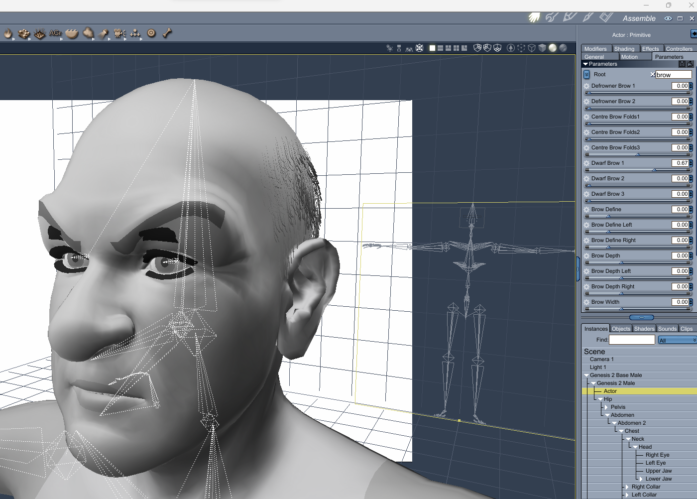

  • kitakoredazkitakoredaz Posts: 3,526
    edited February 2014
    I have not tested with Transfer Utility,
    but when I use Auto fit for body suit with gen2female,
    I have same problem about gen2female head poze controlls.
    then,, to modify them, we need to set auto-follow on about PHMs which used for poze controll.
    some of controller simply move two PHMs so that they do not need change follow type,
    eg Now the genesis2female Blow down poze controll can not auto follow.
    then this poze controll have two sub-component
    PHMBrowDownL
    PHMBrowDownR
    so that I need to check "auto-follow" "on" in parameter tab,
    Parameter setting (right top side small wheel icon) about these PHMs in genesis2female.
    then I need to un-fit the wear once. then fit-to again.
    after that when I tweak genesis2female poze controll , these PHMs auto follow to the bodysuit.
    to easy your work, after pozing genesis2 ,select genesis(actor root), go to parameter tab,
    then see currently used section,with edit mode. (you may need to show hidden parameter option)
    It may show you all PHMs which used by the poze controller.
    (it is shown as M(Morph) not P) then we need to change auto-follow type about these morphs only.
    But to change auto follow type and freeze them,
    we may need to save modified assets, or save thse morph again
    of genesis(2female).
    then it is clear bug. we need to report it. without if vendor release new mask,
    they can not auto-follow genesis2female head pozing.
    my pic show, I only modify Brow Down right (genesis2female PHM) auto-follow type.
    now supersuit only auto-follow about the right side blow movements ^^;
    966 x 627 - 117K
    Post edited by kitakoredaz on

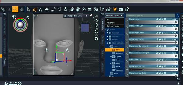

    I record here how to transfer only expression morphs from genesis1 with TU if I need it .
    If you use ds default current version, it is not easy,
    you may transfer all morphs from genesis or, you need to set-up in edit mode,
    and remove morphs which you need not transfer.
    then, In 4.5 beta last version, You can use option to choose transfer morphs.
    1. select Genesis root, in parameter tab. in parameter tab option, check on "Show hideen properties"
    because about genesis1 most of head pozing morphs are set as hidden properties.
    these are not controller. which we find when select genesis1 head. it is important.
    because, we can not transfer any controller how we tweak them in parameter setting.
    how you change type or path,move them to root, there is no meaning.
    we can only transfer actuall hidden morphs. (which change geometry).
    and ALL actual morphs should be assigned with genesis root.
    if you find morphs with another node, it is simply Alias or controller.
    2 go to edit mode, in parameter tab. it clear show us what property type, and easy to select.
    the property is morph, alias, or property,, they spelled as M A,P
    Anyway go to General>poze controll>head section.
    then you may find many PHMs which used for expression or head pozing.
    they should be marked as M.
    3 choose and select morphs which you need to transfer only.
    with Ctrl key (windows). then R-click in parameter tab on your selected morphs.
    select, Auto follow >Enabe auto-follow ON on selected properties"
    Because when you transfer these morphs from genesis, the current option
    should be transfered too. if you keep Auto-Follow OFF,
    transfered PHMs of Target are Auto Follow OFF.
    you need to tweak them after transfer morphs.
    4 keep current selection, then R click again,
    Favorite>Add selected properties to Favorite.
    5 OK, now we can trasnfer PHM for expression to Target.
    check again, in Favorite section, keep select genesis root,
    All morphs which you need are grouped as Favorite,
    and their auto-follow setting is correct (ON)
    in my pic, I only grouped eye blow morphs as favorite,
    which need to use eye head blow poze controlelr.
    OPEN TU, then set Your TU setting,
    you need to set Extended Options for Moprh Target.
    From soruce, Favorites (or Favorites and Sub-Componets)
    if you have missed before, check on Override Existing.
    If you check sub-Component, it may export All mcm which work with the PHMs.
    (I feel usually we need not, because most of MCM are set correclty, then they can be generated
    without transfer them, and not need change setting)
    (check my pic setting, ,I have already transfered weight map etc,
    so that just check on About Moprh Targets, at this time,
    you may use projection template too, if you need)
    6 To check them, first, un fit your Target from genesis.
    then, remove genesis, and reload genesis.
    then Fit to again.
    7 select genessi Head then tweak any poze controller (about my case, only blow controlelr work)
    now transfered morphs should be work without problem.
    if you have already transfered some morphs, they may need to change auto-follow setting too.
    (but as for me, I needed not change setting any more)
    8 then reset-genesis, save your transfered morphs as morph again.
    (but without changing genesis morph auto-follow type, they can never auto-generated,
    which you have not transfered)
    I do not like transfer and save any-morphs without clear reason.(eg I need to modify and overwrite generate morphs etc)
    it is simply genesis morph setting problem. and we need not transfer expression morph,
    if daz correct them for genesis and genesis2.
    How long we need to wait daz simply find correct good setting for DAZ base figure?
    DAZ ofthen change DS, and improbe them, but forget and lose many important things too.
    1081 x 504 - 103K
    991 x 713 - 149K
    1044 x 644 - 151K
    then Fit to again.
