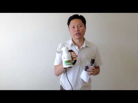

    They make special air guns called datavacs that have a sole purpose to clean out computers and other electronics. I forget how much I spent on mine, but I think it was somewhere around $50 on Amazon. I'd avoid compressed air because it is easy to end up actually getting things wet with them if you aren't super careful and use it at just the right angle (which is really easy to do). I'd also avoid physical contact with a duster because you could end up leaving things you don't want behind, or moving things you don't want to move.
    _have one of these  Metro DataVac Electric Duster  _ bought at  Staples   $68 USD  several years ago   _Super Powerful _ look at this  videos
