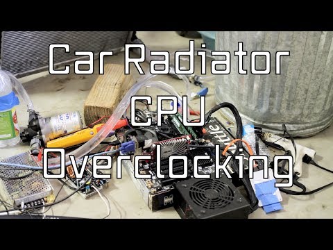

    This is more of a silly idea than a serious suggestion, but I thought I'd share anyways.  I priced some car radiators at my local auto parts store, and they are surprisingly cheap.  I saw one newly manufactured radiator for only $85 that looked particularly well suited for a DIY build.
    Of course the radiator is still pretty large, about the size of a large ATX case, but I figure if you built a frame to attach the radiator and motherboard to, and then either canniabalized an old PC case or something for the motherboard tray and such, and then find some decent mesh grating to encase the system so that my cats wouldn't crawl in...
    It'd definitely have a Mad Max/Road Warrior kinda feel, but that actually sounds interesting to me.  All of this 'clean cut RGB future stuff' gets old after a while.
    Of course, if someone were to actually do this (and at least one person on Youtube has used a car radiator for an overclock attempt of a FX 8350), you'd need to find the necessary adaptors, and of course watch your materials.  Most car radiators are aluminum these days, so you'd need to find aluminum blocks for your CPU and GPUs.  I did find a few aluminum blocks, but the majority of water blocks are copper, at least from what I saw in my parts browsing.  There are also some 'radiator hose to NPT' adaptors, so I figured that a good way to go would be a pair of 4-6 port NPT manifolds and attaching them to said radiator hose adaptors.  Then run the hoses to the pumps from the bottom manifold, returning through the top one.
    You could also run an extra loop directly from the bottom manifold to the top, along the side of the radiator, with a clear tube so that you could visually check your water level without having to crack open the radiator cap.  The car radiator hoses attach at the top and bottom of the back of the radiator, so a hose that passed direcly between these two points, with no pumps attached, should 'equalize' it's level with the level inside of the radiator when the system pumps are idle.  And of course you'd pump from bottom to top, so that you aren't sucking air if the level starts to drop a bit.  The top manifold shoud be well above the rest of the system, due to the radiator height, so it would require a significant drop in coolant level before the radiator fluid level would drop below the level of the water blocks.
    The other reason for using npt manifolds with multiple ports is to allow multiple circuits for the water cooling loops.  This way you could isolate the CPU loop from the GPU loop(s).  This would require multiple pumps of course, and you'd only shave 1-2 degrees c off of each coolant loop doing this, but every little bit might help with the heat throttling on the 3970X...
    The guy that car radiator'ed his 8350 noted that due to the sheer amount of coolant in the system, thanks to the high capacity of the car radiator, and the large surface area of said radiator, that he didn't even have to bother with a fan on the radiator, as his coolant temps weren't climbing more than a couple of degrees during use.  He did ziptie a fan above the CPU water block to cool the VRMs around the CPU though, so that might have helped with the water cooling a tiny bit.  If I do decide to go 'ghetto' with my next build, I'll probably still grab a portable house fan and point it at the radiator and the rest of the computer though, for the summer months since I often use a fan anyways in the summer to keep the air moving in my work area.
    Just wanted to share my madness here.  It sounds silly, until you start to think about the huge amount of surface area on your average car radiator.  You'd also have to be mindful of leaks, but most car radiator systems leak very little once the hose clamps are suitably cinched up when you think about it.  They tend to lose liquid mainly due to the fact the water is often heated near/above the boiling point in the car engine, and excess overflow from expansion gets dumped into the overflow bottle where a bit of it will evaporate from over time.

  • A car radiator is very unsuited to use as PC cooling. The fin density is terrible which means you'd need to push a lot of air across the fins to cool the water enough that means loud fans. Also the volume of water is huge so you'd need a pretty beefy pump, again that would be loud.
    A custom loop for TR and multiple GPU's wouldn't be terribly hard but as pointed out installing blocks on GPU's voids the warranty. In a case like the O11 with more than sufficient airflow I wouldn't bother unless the rig overheats even with good fans and a TRx40 specific air cooler.

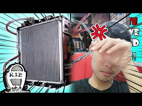

    This guy might disagree with you there kenshaw...
    This next guy is using a heater core not a coolant radiator.  The coolant connectors are a more friendly size, and a number of people that do this have went the heater core route, but the radiator is a bit smaller...
    https://www.instructables.com/id/Computer-liquid-cooling-with-Car-parts/k
    He was quite happy with his temps after it was all said and done.

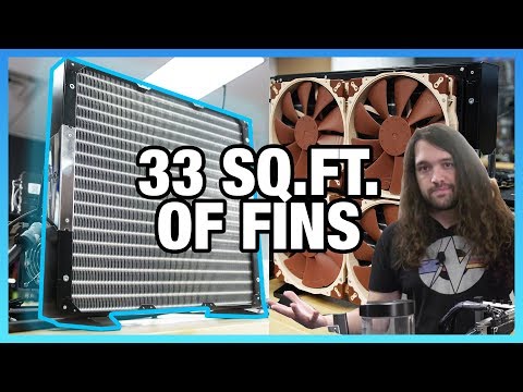

    There are numerous other examples, plus Gamers nexus recently used a fairly large radiator for ther 9980XE overclock livestream.  It's not quite the same thing though, although they did have four 200MM fans strapped to the front of the rather large radiator they picked.  Temps were managaable, but the CPU hit it's hard limit so while Steve did manage a very respectable overclock, there were some niggling issues with the overclock that would take more time to chase down, which would have bored the livestream audience quite a bit there at the tail end, as is usual when trying to eek out the last few percentage points of a maxed out overlcock.  Note that I'm not looking to overclock myself, at least not these days, but i do have to give props to the 500+ watts he was pushing through the CPU
    A few people have went the car radiator route to passively water cool their PC's, no fans needed, but the examples I found weren't really looking to do extreme overclocking or anything like that.  One guy even experimented with a geothermal loop, which was rather interesting...  Another guy gave a 'after 1 year' update, where he drained his system and the system was still quite clean despite mixing copper and aluminum.  He used a new radiator though, not something from a junkyard.  He did note that over a longer period of time he expected to see a bit of corrosion, but he was planning on more diligent maintenance of the loop in the coming years as the components aged.
    Anyways, I already know you are skeptical from previous posts, and I wasn't suggesting the OP go this route, as theres a fair amount of DIY involved.  I just thought the OP would find it amusing and I like to amuse people occasionally.  Plus  I didn't want to clutter up the benchmark thread, hence why I posted here instead, as most people won't be paying attention to this thread in the first place.
    C'est la vie!

  • This guy might disagree with you there kenshaw...
    C'est la vie!
    The guy flat says the pump dies after an hour. The radiator has no fans so when the loop saturates the CPU will just overheat. So it won't actually work except as a stunt.
    That the guy doesn't understand thermodynamics doesn't mean I don't.
    Also did you notice he never shot the rig when it was on? That's because that pumop would have crushed his audio.
    But you should definitely go out and mix metal in a loop. Galvanic corrosion isn't a thing except for you know chemistry and physics.
    BTW that big rad GN used had decent fin density and used 4 fans pushing air through it. And it still overheated. No amount of tweaking voltage by hundredths of a volt was going to change that. When you saturate a loop as fast as that it means you're way past the loops limits.

    Except that even without a fan, the radiator is still radiating heat.  Cars do this all the time when they are parked, and older cars don't even have electric fans that stay on when the engine is shut off.
    It won't radiate heat nearly as fast, but it still radiates heat.  And this is how hot water radiators in houses work as well.  No fan needed.
    Linus even has a video where the promo pic shows a house hot water radiator sitting next to a computer, the inference being using the computer to heat the house a bit... I haven't watched the video though, 'cuz I already know about computers heating up rooms a bit.  I probably should though, just to see if he actually attached his computer to a house hot water radiator, but that's just being silly...
    Adding a fan will help of course, but as I noted, a LOT of people have created passive systems, well passive in the fact that they have no fans.  And as I noted, Linus even built a 9980XE system with a bunch of radiators that was passively cooled.
    Here's Steve's recap.
    He never said the system overheated, he did note that the temps were running in the 80's though, in no doubt due to the 500W he as pushing through the system at some point.  We was pretty happy with the cooling solution, although of course liquid nitrogen would probably yield better results.  He wanted to see how well he could do on water, which was the whole point of the livestream.
    To your point, at some point when pushing the overclocking limits, the CPU just can't shed heat fast enough, due to the aforementioned thermal dynamics.  It takes time to transfer heat from one medium to another.  Normally, this isn't a big issue, but when pushing a LOT of power through the system, you will hit a point where the CPU HAS to throttle, or worse yet just errors out, or if something goes wrong and you push too much power through it and it just fries itself.  Kinda like pushing 1000 watts through a laptop CPU.  It will die pretty much immediately because it was never designed for that amount of power, and to a related extent the resultiing heat that starts melting things...
    This is also why liquid nitrogen is used so often in extreme overclocking.  The huge temperature differential helps the CPU to shed a bit more heat through the exchange process, as the 'heat receptacle', in this case the LNO, is able to suck the heat a bit faster faster through the CPU plate  Plus said LN, even though it's usually not being dumped on the whole motherboard, drops the ambient temps around the CPU a bit, which helps the VRMs and such due to the lower ambient temps around them.
    Again, the key to passively cooled systems is surface area.  Sure, fin density is denser on say a heater core or your 'typical' AIO cooler, but if we are talking a VERY LARGE radiator, say one that is used to cool a 110+ HP diesel tractor travelling at 2-3 miles per hour, burning 8 or more gallons of fuel an hour while pulling a large multi-bottomed plow, while keeping coolant temps below 180 degrees/82c, there's certainly enough surface area to deal with the heat, even with 'just' a single fan pushing air through it...Also, on the flipside, if the fins are spaced farther apart, this reduces the airflow resistance through the fins, simply due to the lower surface area cross section of said fins, allowing more air to 'naturally' pass through the fins, or providing less resistance to air being forced through the fins.
    Tighter fins are designed to work in situations where you have fans spinning at a high rate pushing a lot of CFM through the radiators, but if you are looking at quieter solutions, well it's a tradeoff, said tradeoff being larger solutions vs. tighter fins.
    Or doing completely different stuff like pumping your coolant through a geothermal gound loop, but of course the surface area of said ground loops, when you do the math, is quite significant, not to mention the sheer volume of said soil around the loop, plus the ambient temp of the soil around said geothermal loops is often lower than the ambient air in summer months.  And warmer in winter months of course, which is why geothermal loops work so well for home heating.
    This is why a lot of people that go the external radiator route are reporting temps in the 50s and 60's during 'regular' use over time, even for heavier workloads, as noted in the second article I linked above.  The other key here is that since said radiators are often mounted externally, separate from the case, this improves the ambient airflow situation around said radiators. This should also help with the motherboard itself, as there's less hot air to push through the case, and fewer items radiating heat inside the case (i.e. the radiators and associated hardware) and you won't be pushing VRM heat and such through your already warm radiators, which lowers the temperature differential of said air.
    Anyways, yeah I get that you are trying to show off your 'superior intelligence' here, so nothing to see here, move along.
