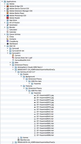

    I tried double clicking no luck. I have attached a jpg of the path where my hdri photos are. Maybe I need to do something with the location?

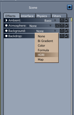

    And you're selecting the hdri option under Background? I see you're on a Mac. So am I. I use C7.2 Pro and have DT's Skies of Terra and it works fine.

    I am using Background and navigating using the browse button on the HDRI panel (Attached PNG Background) I get the attached PNG File).. Is there a setting I need to change?
    The directory in your last screen shot shows a bunch of .cbr files, which are Carrara native browser files. Have you tried maybe opening one of the scene presets that came with it? The lights included in the scene should then match the light direction shown in the hdr image. DT is really pretty good at that. The other render settings should also be optimized for it. You can still still stick anything in the scene you wish, or change any of the preset lights and cameras as well.
    To open an hdri from the hdri browse button in the scene's background it needs to be an hdri, so look for the .hdr at the end of the file name if you're trying to load it manually.

    The files you are accessing are actual scene presets, I think. So if you add that folder to your Misc tab of your browser, you then drag the file from there into your background scene heading, instead of loading as normal.
    The actual HDR Image files that you load on your own are located under Carrara 8.5 > Presets > Textures > Dimension Theory
    The one your showing us is Presets > Background > Dimension Theory
    Big difference.
