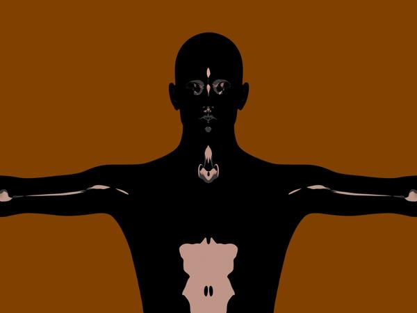

When I render after applying a pwToon shader, everything is jyyust...dark. It doesn't matter how much light is on the figure, or if there isc any at all, it's still black.
This is DS4.6

    Here's a couple renders to show what I mean.
    First one is Neutral. I don't understand the weird eyes. Second is Clean Drawing.

  • Richard HaseltineRichard Haseltine Posts: 107,968
    edited January 2014
    That looks as if the wrong map is being used at render time - try restarting DS, and then do a render immediately on starting. Certainly applying the current version of pwToon base shader over the male sample res textures gives the expected result on rendering.

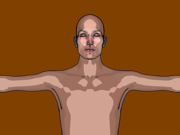

    Then start asking me what to do... I'll tell you to PUT A CAMERA IN IT1!
    Man...that was dumb.
    New question, what's going o under the eyes?
    1298 x 973 - 200K
    Looks like it's outlining each bit of the transmapped mesh - I wouldn't use pwToon on lashes with a standard transparency map, if at all.

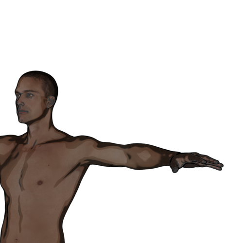

  • LevonasLevonas Posts: 18
    I get your frustration. Take a look at what pwToon is doing to my poor GenesisMale 2 on render. What in the world happened to his fingers and toes?! Haha, pwToon is sadistic and mutilating genesis figures now.
    You see I have the eyes issue as well so you are not alone in this! Now, if you remove the texture and assign materials yourself, then lower the specular, they show up just fine.
    I have repeated the process after restart and this missing geometry render with pwToon is constant.
    He renders fine without pwToon applied so I am at a loss with this pwToon as well.
    It used to work so well before I upgraded my PC. Better part = better render right? Well not with this shader haha.
    1070 x 943 - 138K
    Not sure whats going on but here is M6 pwTooned on my PC just now. Nothing happened...
    942 x 949 - 304K
    That looks like a displacement problem.
    That looks like a displacement problem.I did Confirm that issue on the G2M Base male. It only happens to it. Not to any G2M shapes.
  • scorpioscorpio Posts: 8,533
    The original shader and settings (G2M also has displacement maps whereas M6 doesn't) are different for the G2M and M6, I presume its this that is setting the displacement when applying PWToon
