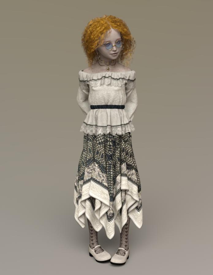

    ..update:
    Well went back to poking around at it and after reading what I could about scaling and shape following
    I right clicked on the dress in the scene tab and selected and fit "none" (couldn't just load it wit no target specified as it still automatically fits to the character), which opened up a number of hidden FMBs and PBMs that didn't show when fitted and parented.  One of the FBMs was for the Molly Body base I used so I set that to 100% then refit the dress to the character, and after turning on smoothing, it fit properly. The odd thing is after fitting it I clicked on Show Hidden Properties and noticed the Molly Body parameter was set to 200% while all other FBM/PBM settings matched matched those used for the character.  When I reduced the parameter value to 100%, the fit issue returned (in the FBM parameters for the character Molly Body is set to 100% and there are no other "character" shapes mixed with it, so not sure why Auto follow kept ignoring my original setting since the last time I fit the dress to this character). The inly thing I can think of was while still developing her shape I reduced the percentage of the base Molly Body when experimenting with mixing other shapes and somehow that is what messed things up.
    Be that as it may, a very odd and frustrating situation indeed. Don't like having to just keep pushing buttons until something works, push the wrong one....
    Post edited by kyoto kid on
  • kyoto kidkyoto kid Posts: 42,109
    edited January 2020
    ...and here she finally is.
