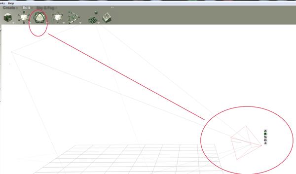

Right...I had to use my free Personal Learning Ed. on my PC to simulate the problem, since I can't work out how to make a simple screenshot with IrfanView on my laptop. But, anyway, I did it here...even though on the PC the free program didn't seem to want to get wonky, so I had to force it to!
Here's what I have got...an exaggerated version of the trouble so that it is easier to see...when I adjust the FoV there is rotation that I of course do not want, and that is what makes my horizon get all skewed... And Bryce 7 doesn't seem to want to cooperate and let me straighten the angles. So how can I do that?? :-/

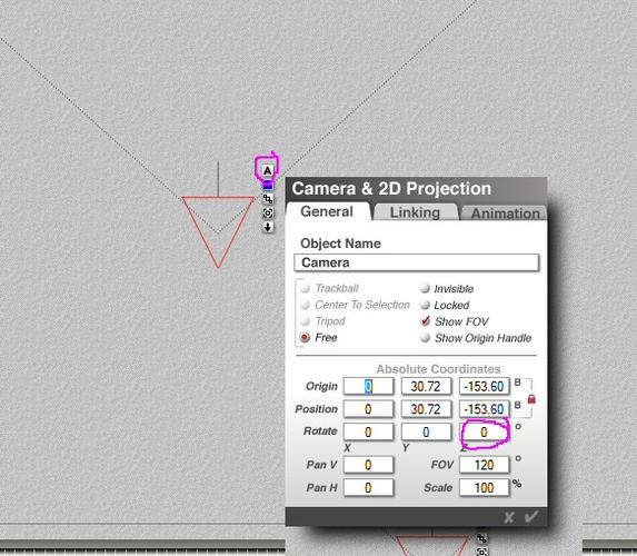

Well, I don't know how this happened, but it should be easy to fix.
From the overhead view (keyboard shortcut "2"), select the camera, click on "A" and set the z value shown to zero. That will take the bank out of the camera.

AHH, thank you, that should do it!! The notion of going into Adjustments did occur to me, but there was I, trying mightily to make corrections manually....Duh!! Now occasionally I can imagine that one might actually want the horizon to bank that way...it would look like the view from an airplane, preparing to land on a tropical island or something... :) But in my case, noooooo, that is too advanced, lol
