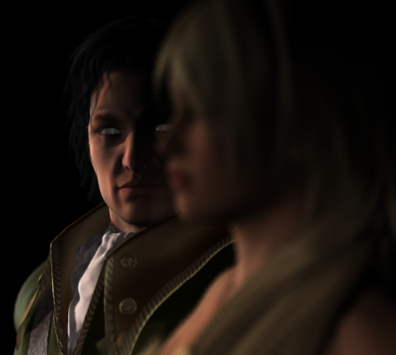

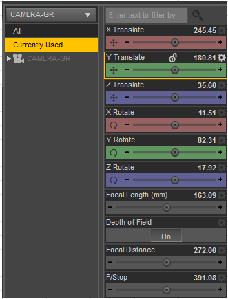

Long story short, I wound up with an "accidental" DOF while transferring some models from another scene and I want to use it :-) However, it does not seem to be "obeying" the typical DOF settings I've learned about from you guys (i.e. Focal Length, dof, focal distance and f/stop)]. So I thought I would post 2 scenarios and maybe someone could explain.
First is the "accidental" - I'm posting Camera in Perspective view, Render and DOF settings.
See how the f/stop is all crammed together?

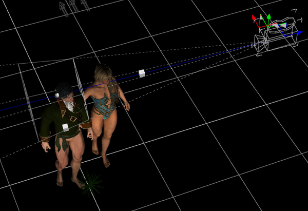

    So in this second post, I'm trying to manipulate the DOF settings and cannot seem to come up with the same blurred result in the foreground character.
    Maybe someone could shed some light?

  • XoechZXoechZ Posts: 1,102
    The "sharp box" is very narrow here, so everything outside will blur very quickly over distance. His head is much closer to the sharp area than her. So she is already blurring a lot more than he is.
    The "sharp box" is much broader here than in your first example. So blurring will not start so early. Thats why her head is still almost sharp.
    Generally said (not very technical but practical): the narrower the "sharp box" from the DOF setting is, the earlier and heavier the blurring outside of it. So it is not an accident, it is just showing its nature :-)

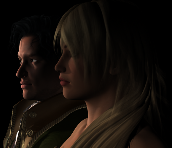

    So I've been playing with this an cannot seem to find a way to keep her REALLY blurry as in Happy Accident and get him nice and sharp. I think I'm trying to break some law here, lol. A DOF policeman may be writing me a ticket as we speak!
    Try to move the center of the box to the middle of his head. But keep it narrow. Maybe that helps.
    I am also no expert with this. As I said in the other thread, these are just my experiences with the DOF effect. It takes me always a bit of trial and error and some test renders to get it as I want it.
  • McKinnanMcKinnan Posts: 0
    I think that idea is going to work! Again, never would have thought of that - way to get creative XeochZ. I think once I fix my lighting in this, I will be very happy. Thank again!

    I alway do what you do: create a new camera, click top-view to adjust the 'box'
    If you don't like that, there is another way to check the DOF area:
    You choose a color, (in my case blue) and switch on and off the near and far DOF plane visibility.
    Everything between those blue screens should be in focus.
