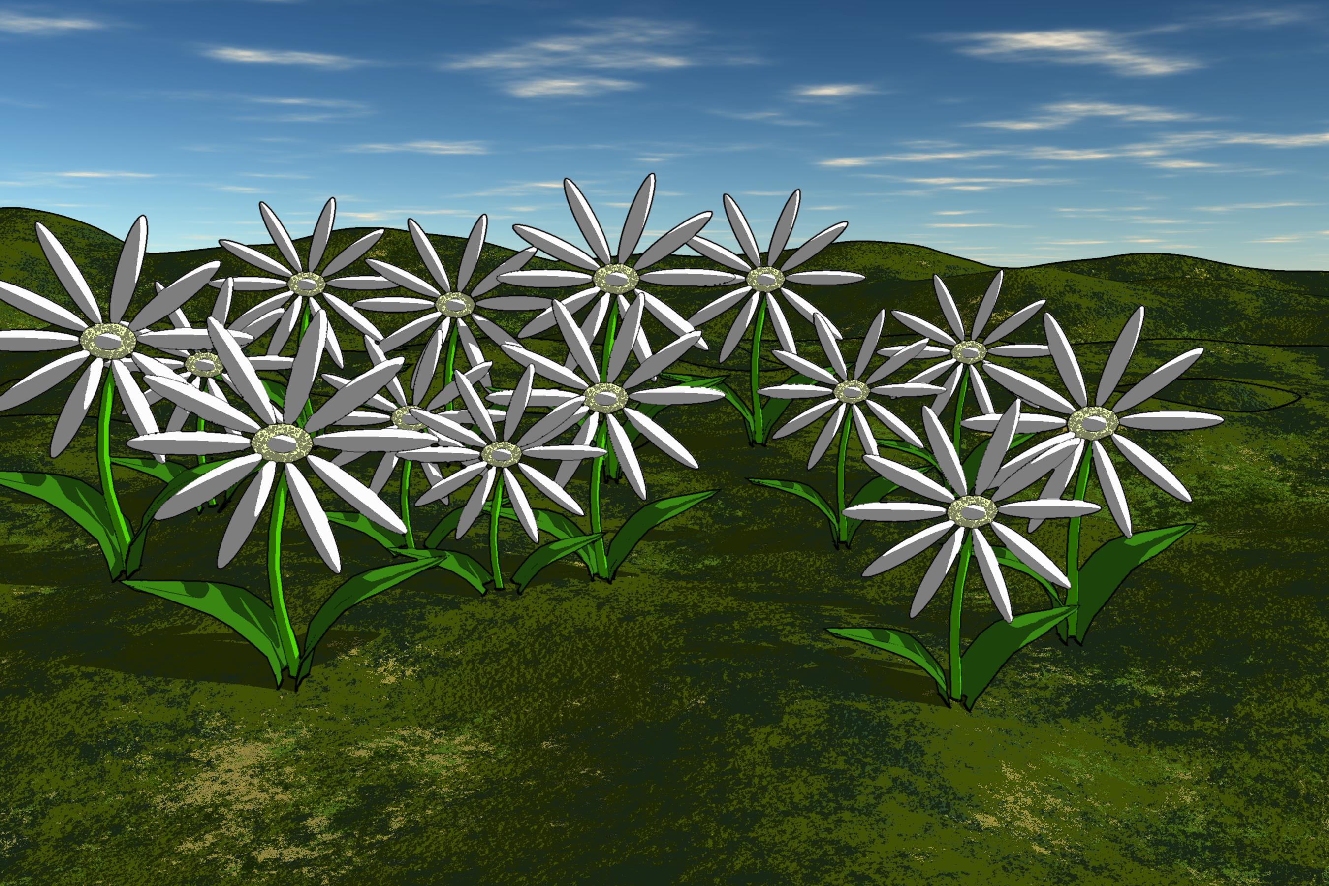

Nothing brilliant here. Just some basic vertex shapes modified with the scale and rotate tools, and tweaked with soft select. There was something new - I figured out how to assign shading domains. Yay! Then surface replicated onto a plane, slightly below a terrain.
Great start. I'm always a huge fan of NPR! You will find assigning new shading domains empowering. For example, there are many clothing items for which you can change the style easily, such as making a long sleeve shirt a short sleeve shirt (depending on the mesh).
- Don't be daunted by the notion of modeling a custom leaf from a reference pic. It really is just a few steps.

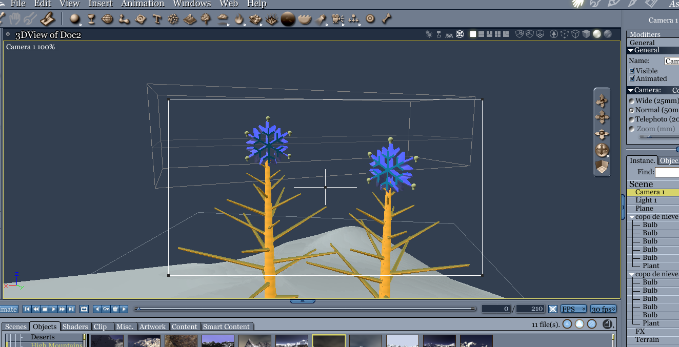

hung my snowflake on tree as leaves.
it wouldn't let me tweak the 2 shading domains on it.
Spectacular!
Which element are you having trouble tweaking shading domains? The tree in its entirety? The snowflake leaves? The tree trunk? Branches? Top star?
Thanks. the snowflakes leafs. when i take the plant into the shader room, i see the trunk, the branches, and 1 shader domain for the snowflake. no big deal tho just an observation.

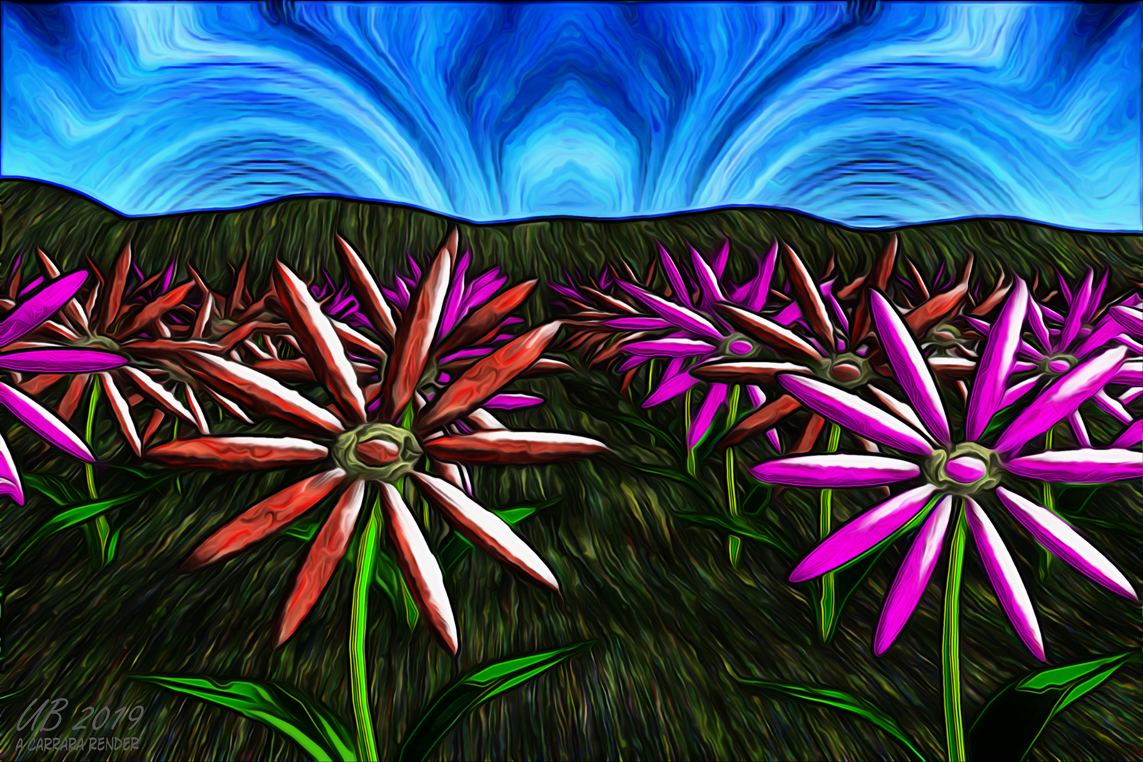

I used a layers list to assign shading domains and replicator masks to the base terrain. I changed the heightmaps a little, but the basic concept is still the same. Most of these plants can be found on my ShareCG account. Feel free to put them to use (if that is allowed ).
Brilliant!!! Now we just need to break you away from Always grivitating to the surface replicator. For this scene, you could have just as easily left the plane at home and used the replicator instead! ;)
Thanks! But I was trying for some random distribution. Isn't the plain replicator more orderly? I went back and set up the flowers again (render to follow), this time in the replicator. Great for plants in an orderly garden, or men marchig in columns, but maybe not so good for random placement?

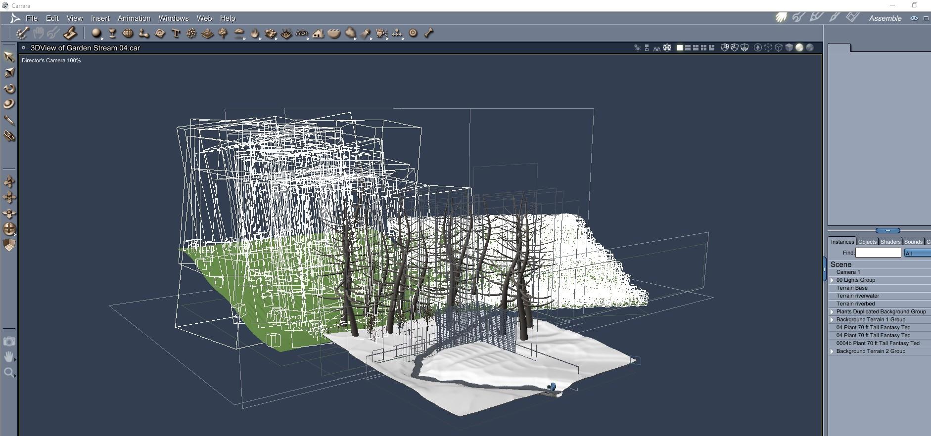

Almost done with everything EXCEPT the garden - haha. Some more replicters. Modeled a bridge for the stream. Need to rough it up a little with morphs.
Thanks Diomede. Filter stack - from top to bottom, GMIC Color>Basic Adjustments, Toon 3, GMIC LyleJK, GMIC Dream Smoothing.
For those who don't know, the filter stack is similar in hierarchy to the Layers List. The top filter has the initial influence, and the bottom filter has the last influence.

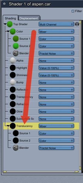

Translucency is perfect for materials that you don't want to have the ability of casting fully dark and heavy shadows - like tree leaves and especially flowers, candle wax, etc., etc.,
Here's a quick example, using the Basic Aspen leaf from Carrara. I Ctrl + Drag (copy drag) the Color Gradient down to the Translucency channel for the leaf on the right. Check out the shadows.

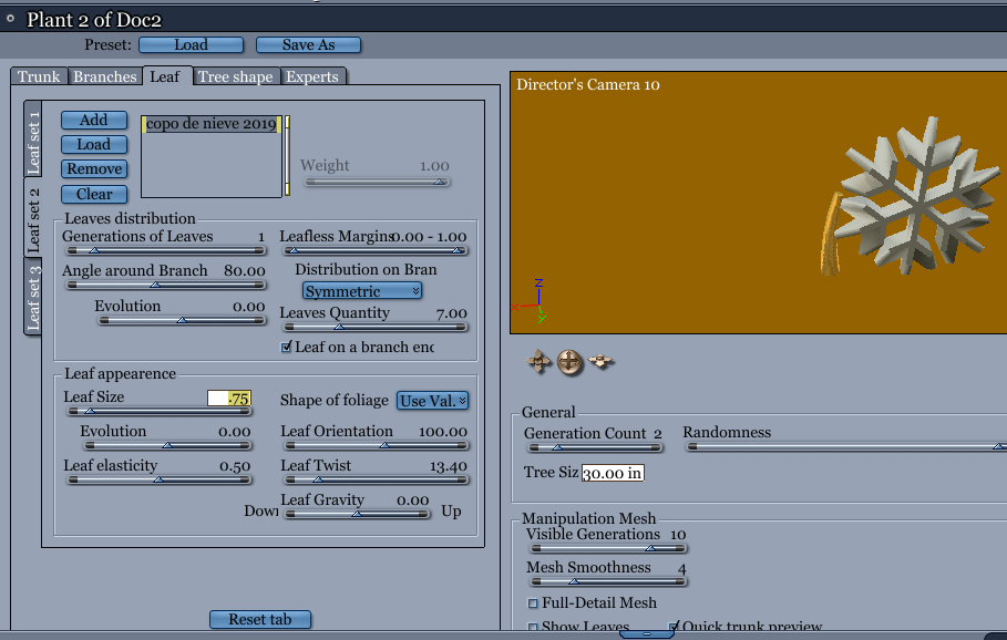

Is the snowflake a vertex object? If not, convert it to one and edit away.

I think leaves need to be one domain
seems t be true.
it's the same exact sflake.car as the one on tree top. the light bulbs didn't come thru on the leaf flakes.
thanks.
i used a metal shader on the tree branches for the silver and gold look

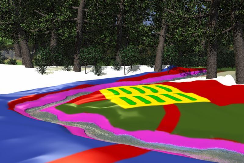

Ha, to me, what I did was a lot easier. :) In other words, I used tools that I basically know. What Diomede was doing - tracing a reference image - I didn't even know where to start.

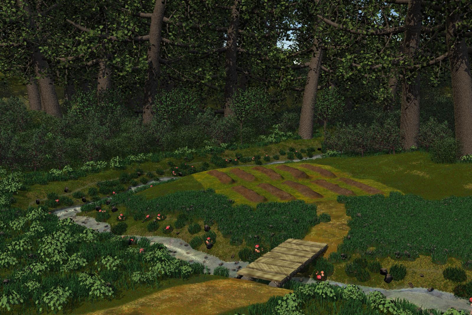

Vincent's Garden
This one was unplanned. I started playing around with the plant, the replicator and GMIC, and saw some possibilities.
All done in Carrara.

And... WOW right back at you. I know it can be hard to know which of the GMIC stacked filters does what, but I'd love to know your recipe. Most excellent.
