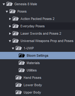

    The folder called "Universal Weapons Prop and Poses" for each of the 4 supported figures has 4 sub folders.  The first one is 1-UWP and in that folder is the Bloom Settings folder for the product
    So if you are using it for Genesis 8 Male, you will find it through this folder path:
    "People > Genesis 8 Male > Poses > Universal Weapons Prop and Poses > 1-UWP > Bloom Settings"

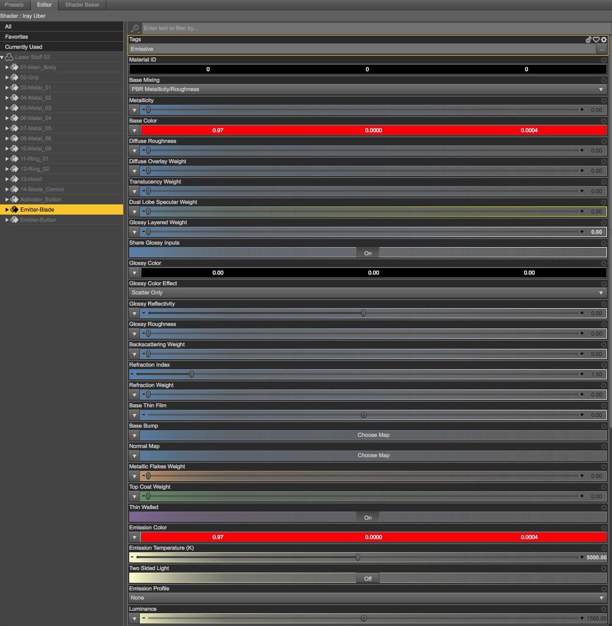

    I am sorry, I did not understand your question properly.  To make the laser blade itself appear red in the render, go to the surface tab, select the blade surface and right below the Emission color, which is bright red, you will see "Emission Temperature (K)".  If you change that from 4000 to 1000 then the laser blade should look red when rendered.  Hope this is the answer you were looking for and that you have more fun with the product!  Thank you for your support.

    Yesssss, better with Surfaces/Laser Sword/Emitter-Blade/Emission Temperature
    Changing 4000 to 600 the laser changes from yellow to red

  • To fix the laser swords you just increase the color to darker. The base color is too bright, so if you use a darker red it will start looking more and more red.
