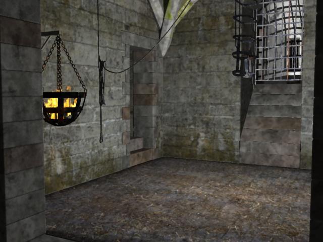

    2)  I started a new Carrara scene and dragged the castle dungeon figure from its library location into my scene.  After it loaded, I selected the "model" level and entered the vertex modeler. There is a wall around the scene, so I selected the outer wall and used the "hide selection" option from the view menu so I could see inside.  I used the selection menu to select by shading domain and selected the lamp flames.  That confirmed the name of the shader domain for the lamp lames.

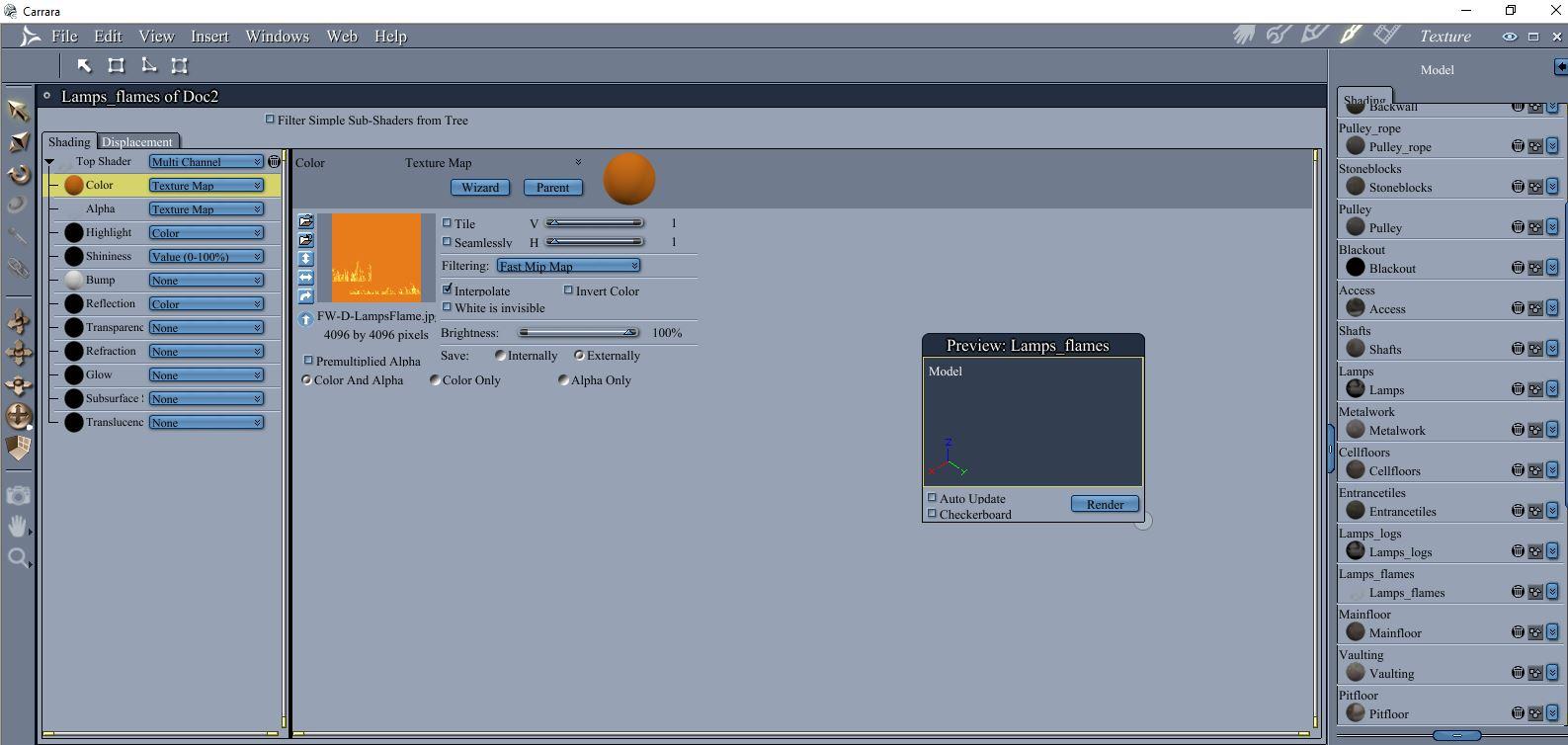

    3)  With the lamp flames selected, I went into the texture room and adjusted the shader for the flames.  For this real quicky, I copied the map from the color channel to the glow channel.
    See - nothing in glow channel.

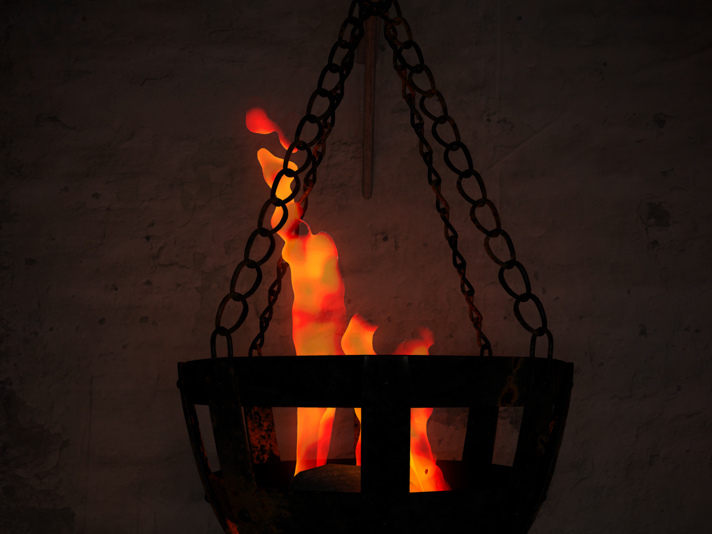

    here ive copied the color channel and pasted to the glow channel.
    4)  I inserted a bulb and did a test render.
    5) You might want to place more focued bulbs or spotlights in with the lamps and not in the geeral scene.  My test render kind of sucks, but hopefully you can see the flame glowing.
    zz01 lamps flames found in model level of castle dungeon figure aftr hide some walls.JPG

    zz02 shader tree for lamp flame could copy flame color map to glow channel.JPG
    1587 x 754 - 142K
    1588 x 730 - 132K
    640 x 480 - 43K

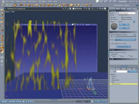

    FLUIDOS II would be helpful too.
    1440 x 1080 - 1009K
    Post edited by Alberto on
  • DartanbeckDartanbeck Posts: 21,959
    Absolutely! Remember my water splash vfx tutorial thingy I did with Fluidos before? Well for flames like this, we can use Fluidos II and render animated flames in many situations, and play the result on a card that is attached to a torch, or whatever. I do that now with stock footage video - Fluidos II will be even better - All Carrara/DS!!!
