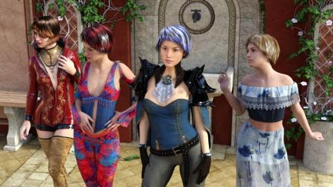

  • PadonePadone Posts: 4,069
    edited November 2019

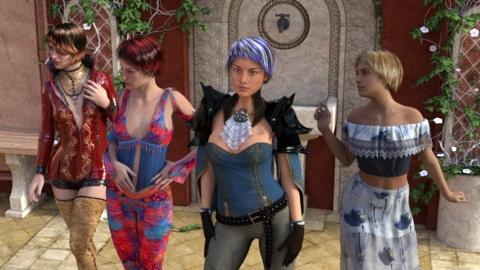

    marble said:
    It seems to me that there is a serious gap between expectaions and reality when it comes to bridge utilities between DAZ Studio and Blender.
    Below there's the same scene rendered first in iray then in cycles. I imported it with the diffeomorphic plugin in just one click. No adjustements made of any kind. The only thing I did was to convert all the meterials to iray inside daz studio before exporting, since G1F to G3F use 3delight materials, again this is done in a copuple of clicks inside daz studio.
    So personally I find the diffeomorphic plugin very effective and easy to use.
    480 x 270 - 98K
    480 x 270 - 101K
    Post edited by Padone on

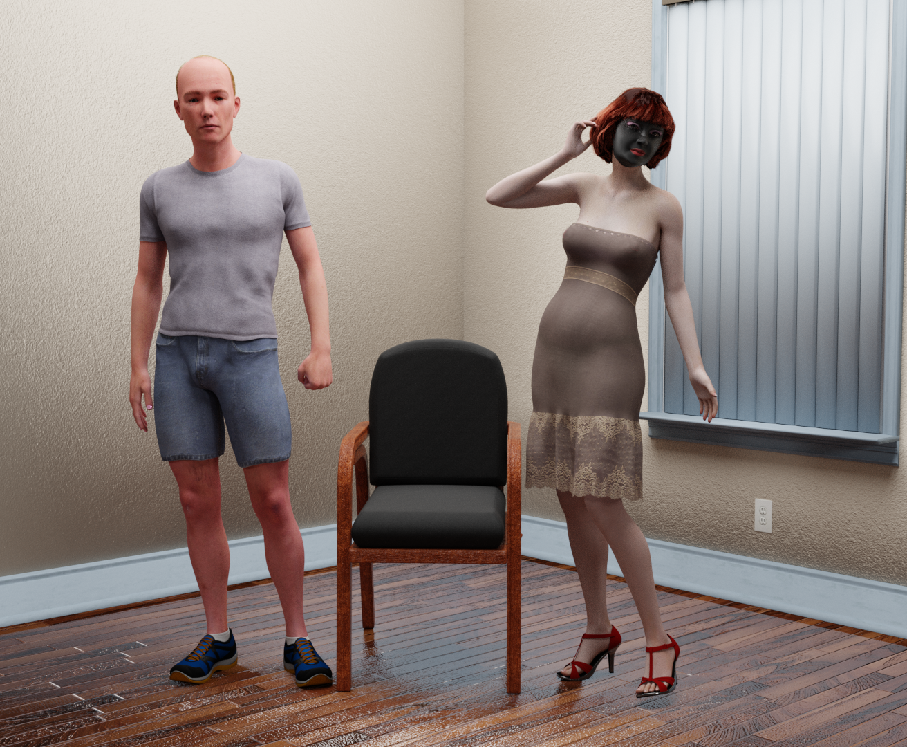

    Just by way of comparison, I did do two renders. One using IRay and one Cycles after exporting using Diffeomorphic. You can be the judge but even this was not one-click. I suspect that you and @Padone have some settings already configured that apply automatically and which I have not yet discovered. I had to add an Area Light because the exported Ghost Light was not recognised. The eyes look all wrong to me and the fine detail is missing - on the dress, for example. The hair on the woman looks wrong too. On previous attempts I had problems with geografts but they are not visible in these renders.
    1600 x 1280 - 4M
    1200 x 1080 - 3M
    Post edited by marble on

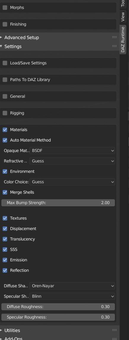

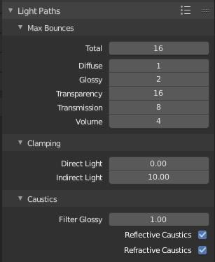

    The pictures you posted don't seem that bad to me. Some difference in skin tones may be expected especially if the skin uses translucency together with sss that is difficult to get exactly the same in blender. Don't forget that iray and cycles are two completely different engines. I find it odd the difference in the dress color though. Also I always use the last development version of the plugin, not the stable version. As for my settings I do the following.
    1) Convert all materials to iray inside daz studio before exporting.
    2) Set cycles as rendering engine in blender, then import using the plugin auto material option, with bsdf for opaque materials and guess for refractive materials.
    3) In the blender color management set the filmic view transform with medium high contrast.
    The iray tone mapping is not imported so if you use settings other than the default then you'll get a different tone mapping in cycles and you have to play yourself with the color management options. As for lights they are imported quite fine, including hdri and emissive geometry.

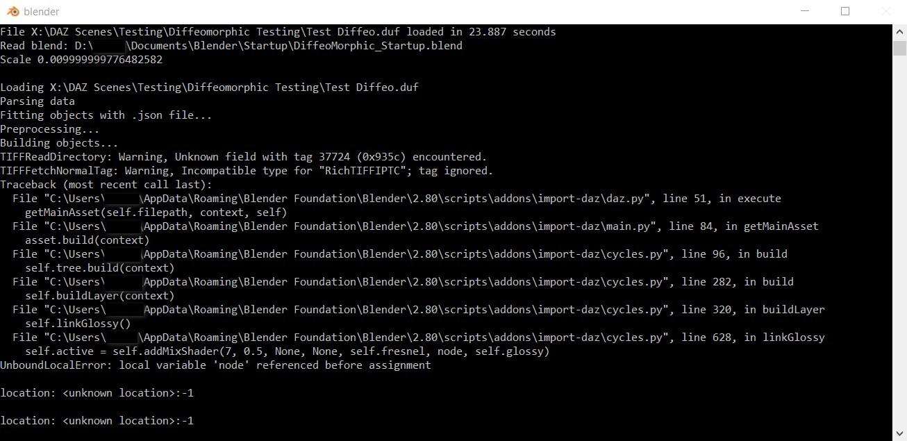

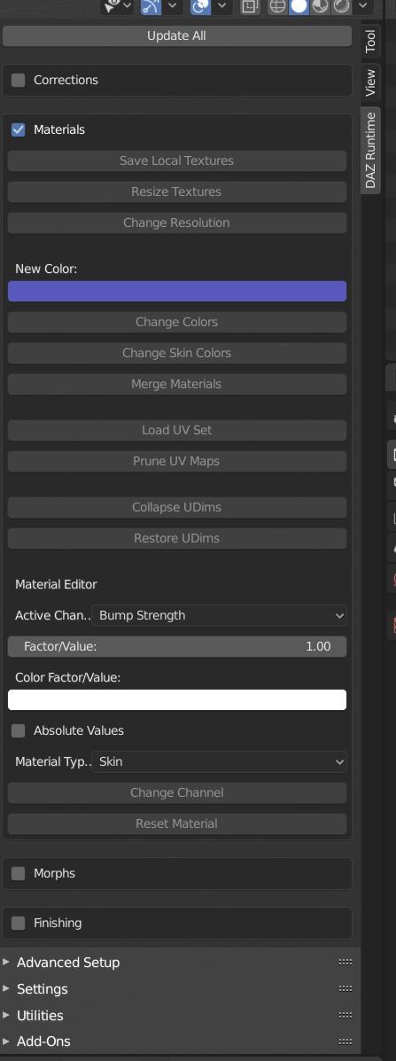

    I am trying out your suggestions and I did find that I had the render engine set to Eevee on import so I have changed that to Cycles. Unfortunately, that came with its own issues and I immediately started getting errors and a failure to import. I checked on the Diffeomorphic blog (and the Blender Artists page dealing with this plugin) and found that others too have had the same errors.
     I don't know the cause as I can't find a response from Thomas but replacing the stable version with the latest development version seems to have fixed it.
    I'm starting to think that there is enough interest in exporting to Blender (and importing from Blender) that there should be a dedicated thread in the Technical sub-forum. Hopefully, people with experience and good knowledge of the process and the tools could share that knowledge in a single, comprehensive thread. I'm talking specifically about DAZ Studio <-> Blender interaction, not about using Blender in general. This might include the creation of morphs and animations. I, for one, am not clear whether experienced Blender users prefer to export scenes to blender and animate there or to animate in DAZ Studio and render in Blender.
    1306 x 635 - 176K

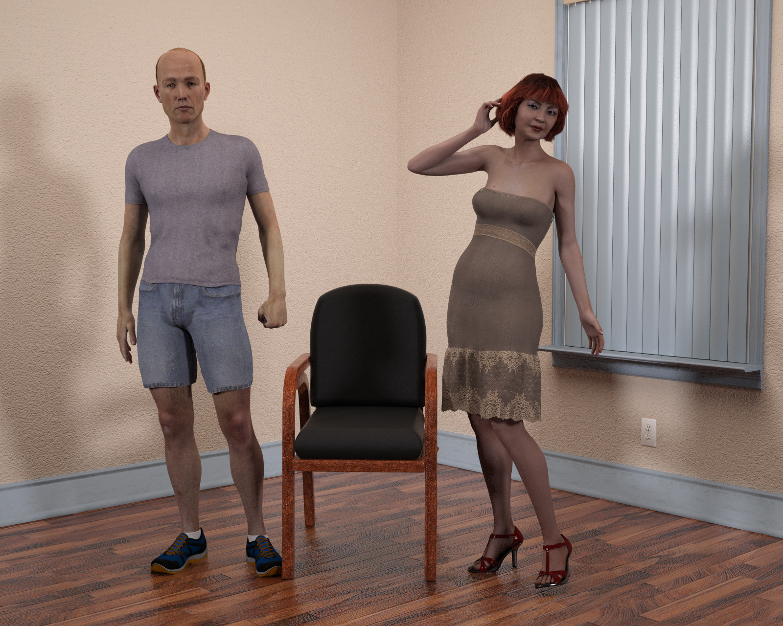

    OK, back to my testing. Here's a Cycles render produced following the settings recommended by @Padone. I should mention that I had to do a little postwork because of some immodest poke-throuch on the dress which doesn't happen with IRay in DAZ Studio. I note that the eyes are still merely black holes and, of course, the most obvious problem is her shiny black "mask". I suspect that this is the exporter not dealing correctly with DAZ LIE which was used to apply makeup to this character. Interesting that this did not occur with my first render before I changed the engine to Cycles before importing the .json file.
    1312 x 1080 - 3M

    My guess is the reason you did not suffer the black face LIE problem in the original render was because you still had Daz Studio open. The minute that was closed (or another DS opened) the temp files are zapped, and no longer available to other apps.

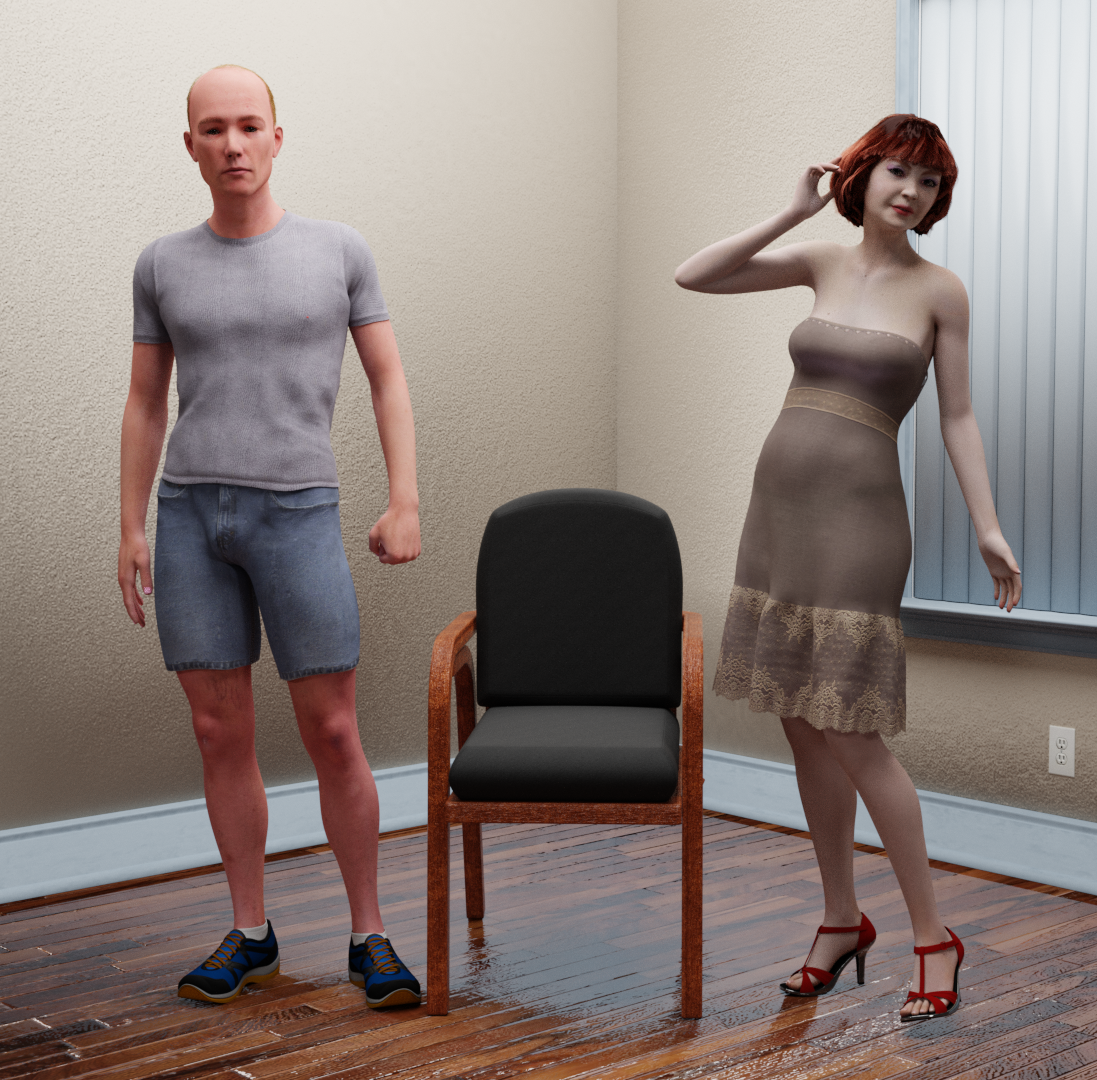

    I believe (but I'll have to check) that I "baked" the LIE textures because I normally run my scenes through Scene Optimizer which, as I understand it, does bake them. Of course, I might be wrong about that but I'll check.
    EDIT - I did check and it turns out that I had not used Scene Optimizer on the female character. I've done that now and the black mask has gone. Still have black eyes and I still consider the Cycles render poor compared to the IRay one but then I have a lot more experience rendering in IRay than I do with Cycles.
    1097 x 1080 - 2M

    Marble, did you try the "Update for..." and choose Cycles in the Materials tab in the importer?
    Sorry, I don't see that option. There are two sections of the importer panel with the Materials heading but I can't see "Update for ..." in either.
    You're right, it's gone with 1.4 version.
    marble said:
    Still have black eyes and I still consider the Cycles render poor compared to the IRay one ..
    That never happened to me with the guess option for refractive materials, that's specific for thin glass and eyes. Which character is that ? Can you reproduce the issue with a standard/free G8 character ? Are you sure you converted the eyes materials to iray before exporting ?
    Also you need to enable reflective and refractive caustics in cycles to correctly render G1-G8 eyes, since they are built in refractive layers. And you need at least 4 or more transmission bounces. Just use a high quality integrator preset and it should work fine.
    As for cycles vs iray, I don't know what you mean by "poor", but as a fact cycles has a much better denoiser that preserves details even with few iterations, while the iray denoiser tends to blur out details. Technically that's because cycles uses the albedo and displacement buffers for the denoiser while iray doesn't. To me a good denoiser is the most important feature because it allows to render fast. So cycles wins by far.
    https://www.daz3d.com/forums/discussion/316206
    307 x 375 - 22K
  • marblemarble Posts: 7,500
    Padone said:
    marble said:
    Still have black eyes ..
    The male is a G3 character called Dale. He comes with IRay materials so no need to convert - I only use IRay materials. I have checked that I didn't use 3Delight by mistake (I didn't). Getting late here now so I'll try a standard G8 or G3 tomorrow.
    When I said "poor" I only meant that my attempted Cycles render was poor compared to my IRay version. Clealy I don't know Cycles a fraction as well as you do so I have a lot to learn yet. I don't doubt that better results are possible but what I am not sure about yet is whether the payoff for the time spent getting to know Cycles well enough will be significant in terms of time saved.
