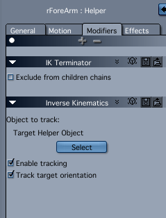

    The elbow isn't the end of the chain, so you may need to change that. Then the target helper may work better. I added an IK Terminator and IK tracking to the forearm. It seemed to help. You can also perhaps change the constraints or lock them.
    The thing with the target helper and the tracking that if you move outside the rig's limits, it the tracking can only do so much.

    Thank you for your quick answer to this question. I tried again with your proposition and it seems to work :)
