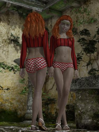

    Greetings,
    Cypherfox said:
    I've been having the crappiest luck with SSS lately. I can't render anything using Julie's skin, for example (which is SSS only, AFAICT), and most other SSS skins look like crap also. Zombie-like gray, mottles, banding... I've given up on SSS for a while.
    Do you have multiple items using the SSS shader in the scene?Do instanced nodes count as 'multiple items'? And if so, how do you change the SSS group for the instanced node? (That's a trick question, I'm fairly sure you can't.)
    This is from a test render I was doing recently with converting some 3DAge outfits to Gen2F, sorry about the semi-prurient nature inherent in 3DAge's clothes... :) I've reduced the resolution (the original is 2048x1536), so hopefully nothing untoward is visible.
    MRTD: 2 or 4, I forget, but it doesn't matter, it definitely happens with 4 as well.
    Pixel Samples (X): 16
    Pixel Samples (Y): 16
    Shadow Samples: 32
    Shading Rate: 0.10
    Gamma correction is off, gain is 1.0, and pixel filter width x/y are 6 each, but I'm fairly sure they're not involved.
    Lighting is a UE2 (Occlusion w/Soft Shadows, shading rate: 4.0, samples: 96), two specular lights (one spot, one infinite), and an infinite light (shadow type: raytraced, 5%, 0.25). (All stock from Andrea AOIBL, to be precise.) No shadow maps, as they're just broken in 3Delight/DS, so any shadows are raytraced.
    The characters are a G2F and a Node Instance of the same G2F, rotated. I thought I was clever with the fingers interlacing. ;)
    [Edit: Added a second render (different outfit), with Max Ray-Trace Depth of 4. Also added more lighting details.]
    -- Morgan
    768 x 1024 - 479K
    576 x 768 - 181K
    Post edited by CypherFOX on
  • Richard HaseltineRichard Haseltine Posts: 108,720
    Instances may confuse the issue as any surface with the same group ID is treated as part of the same item, so you can get scattering from one item to another. however my main concern was that you might have surfaces with the same group ID but different SSS settings, which can by a cause of problems

    Greetings,
    I decided to kick off a render w/o the instance, just to make sure, and it still look zombie-like.
    I wish I knew what was wrong. :(
    -- Morgan

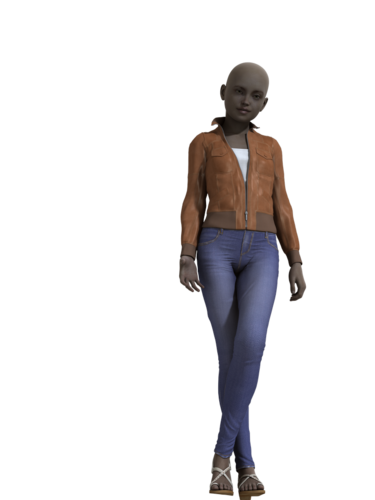

    768 x 1024 - 255K
  • CypherFOXCypherFOX Posts: 3,401
    edited December 2013
    Greetings,
    While the above image (singleton) appears to show it acting alone, I had merely 'hidden' (by clicking the 'eye' button) the clone. If I eliminate the clone entirely, the problem actually goes away.
    I've seen other issues, mostly banding on medium-far characters, but this ashen skin problem was killing me the worst. Now I know that it's due to the clone being in the [strike]image[/strike] scene.
    -- Morgan
    Greetings,
    It's Teen Josie, out of the box, honestly. It's pretty trivial to duplicate. Load Teen Josie, render. (Even the headlamp works for this.) Looks fine.
    Make sure Josie's selected (Genesis 2 Female). Click Create | New Node Instance, select Copy Selected Character.
    Move the clone off a little bit, so it's not touching. (Doesn't matter, but reduces the variables.)
    Now render again. (The headlamp is fine, the lighting doesn't matter.) The resultant render has Josie being all...zombie-like, with the ashen grey skin and all.
    Dunno why, but instancing just plain breaks the SSS skins... It may be different for skins implemented differently, I'm not sure, but I know that Josie's blows up that trivially.
    -- Morgan
  • RogerbeeRogerbee Posts: 4,460
    Oh, right, sorry, I thought it was a dark skin texture, now I see there really is a problem. It's an odd one too, I'm sure someone can shed light on it.
