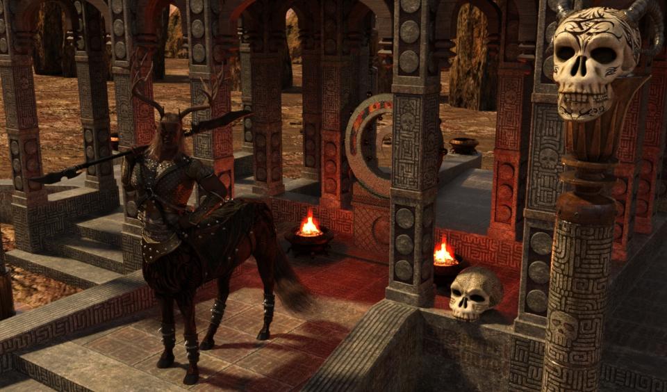

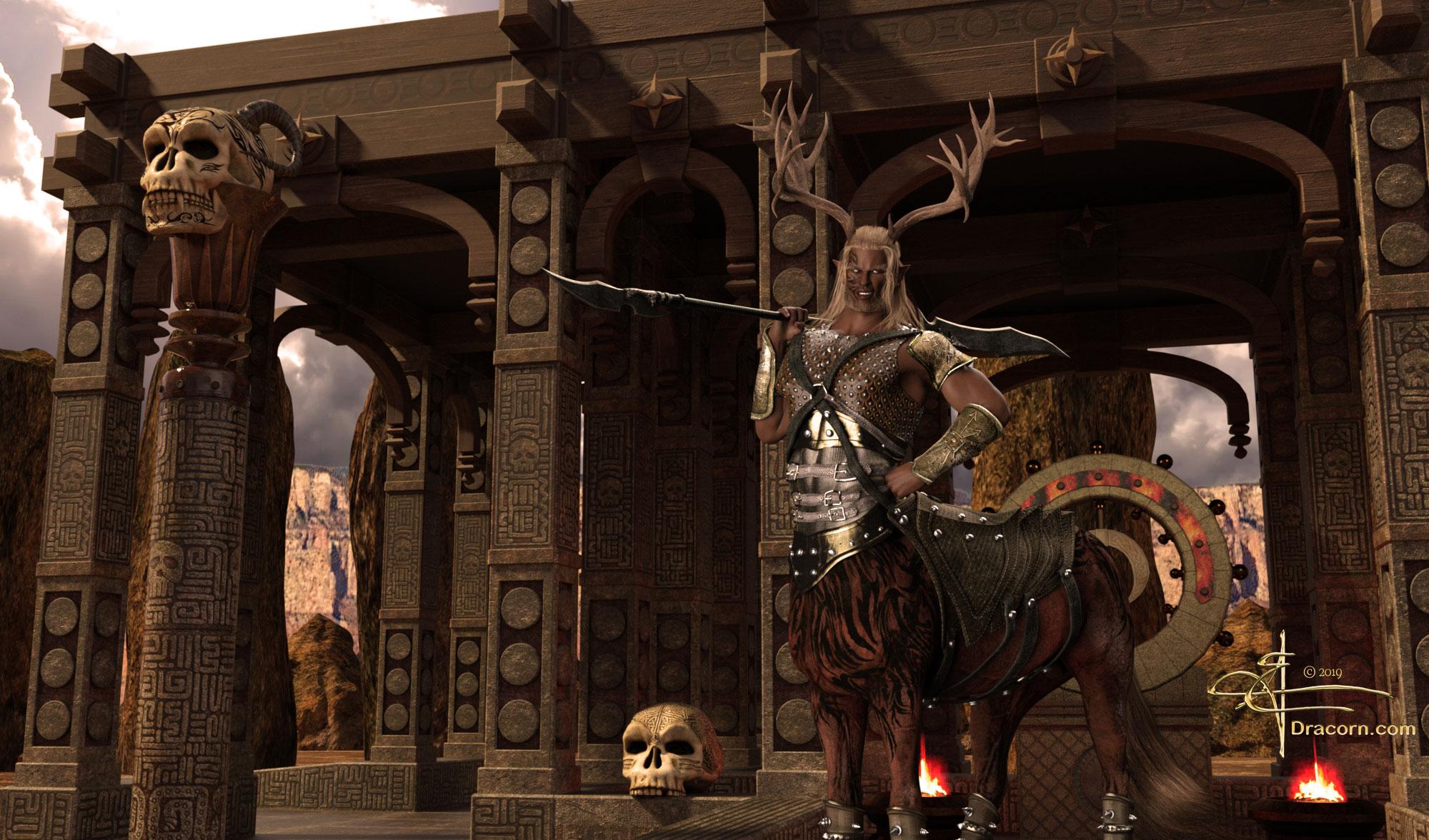

On more than one occasion, I create an outdoor background and use an HDRI or in this case, Iray Worlds Skydome.  My background looks good in the test renders, and then I add my character, who is too dark.  I try all kinds of things to add more light to the character - but it makes the whole render too light and I lose my cool shadows and still the render is grainy and my character is not lit well enough.  Dark skin adds an additional challenge.
Finally in frustration, I changed the camera angle and rendered the background by itself, then rendered the character by himself, which allowed me to use LY Leonine Pro HDR Lighting.  I composited the two renders in Photoshop and used a warming filter for a minor adjustment on the character to make him blend into the background.

    In the first image I would try a Primitive Plane along his near side, big enough to hide him and pulled back a few centimetres so there is space between. Go to the Surface Tab, make sure the plane is Iray, and set the Cutout to 0.001, or add a zero until it disappears. Go to the Emission settings and change the colour to white, Temperature to 4500 and lower the Luminence until there is just enough light to lighten the dark side of your figure.
