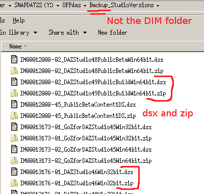

    in the dim zip folder, assuming you told it not to remove the zips after installing the items, will be an IM00012000 or IM00013176 files.   you will want to copy them zips (and associated 'dsx' files) over to a backup folder somewhere that DIM can't see it.
    FYI, DIM will overwrite them zips when you install a newer version of studio.
    P.S. my sympathies, I have a 4GB GT730 in a computer the newer DS 4.12 required GPU driver does not support. That comp is staying on DS 4.9.  I also don't know why I saved the old as dirt 'GoZ' I don't have nor need nor can afford z-brush, lol. good practice, back up EVERYTHING, and sort it out later, much later, lol.
    Oh, and that 'dsx' file is for telling DIM "it's ok to install it" should you need to revert back, something to do verifying it was yours or something like that. hence why you need to backup both of them files.
    Note that if you have any version-dependant plugins you should save their .zip and .dsx file pair too - the ones that spring to mind are: Dynamic Clothing Control (the Optitex kind), Decimator (the full version) and the GoZ and Photoshop bridges.
