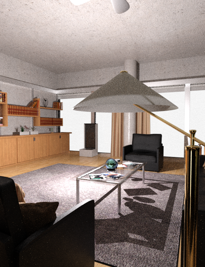

  • GordigGordig Posts: 10,641
    edited September 2019

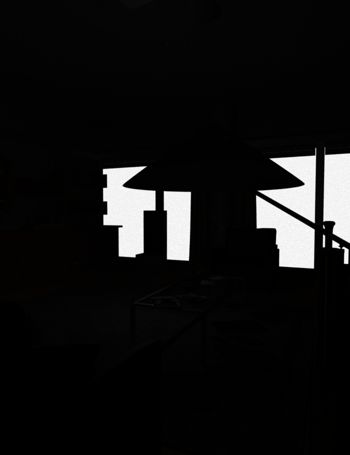

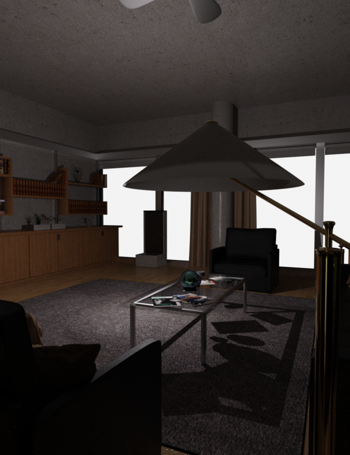

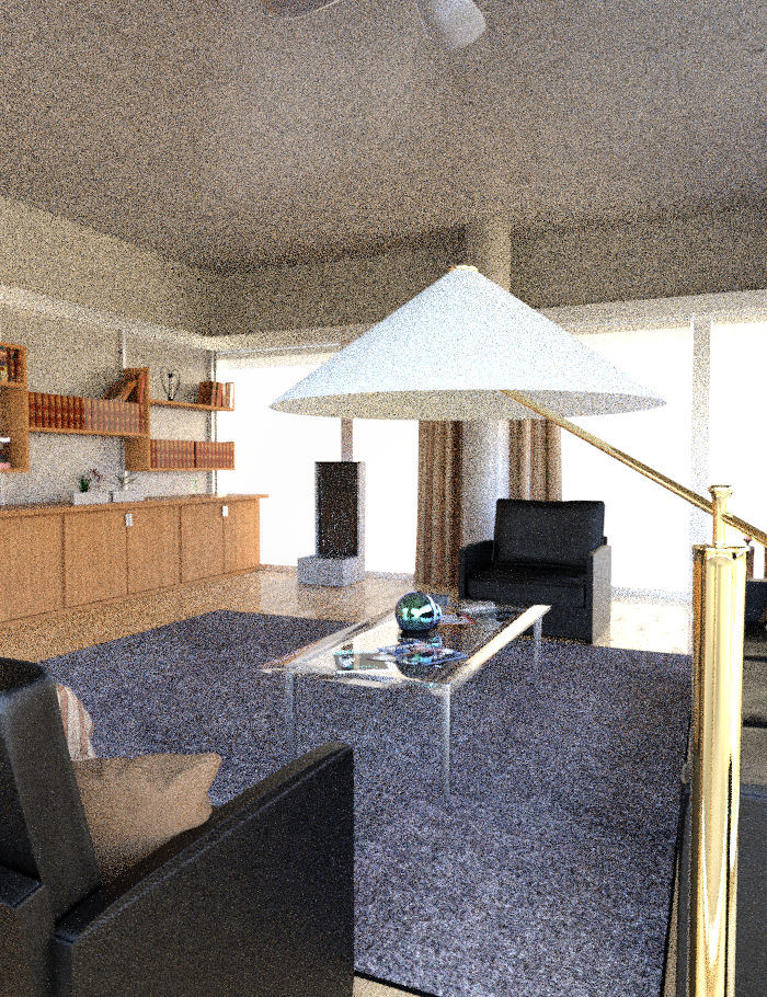

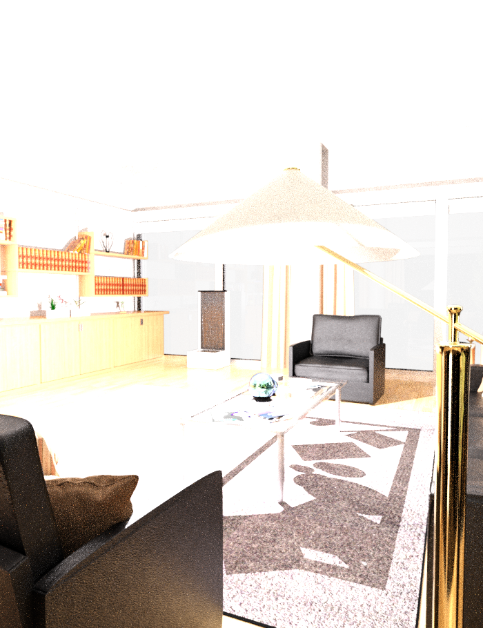

    Have you ever adjusted the CM^2 setting in tone mapping? It changes the intensity of all lights simultaneously by multiplying the luminosity setting by whatever number you set. Here's a series of renders of the exact same scene, with completely stock settings on the light itself.
    Headlamp off, scene only lighting, no lights. Total darkness, as would be expected.
    Added a point light, with the CM^2 factor at one, which is the default. The light barely shows, which is what DS Iray users are used to.
    Throw a zero on the CM^2 factor (10), and now we're starting to get some illumination.
    Another zero (100), and now we've got a more accurate representation of what 1500 lumens would look like.
    Another zero (1,000) and we've got good, even lighting that one might see in an actual room.
    Yet another zero (10,000) and now our standard DS light is totally blowing out the scene.
    Not only does this spare you the trouble of having to adjust every single light individually, it also lets you keep your luminosity settings at manageable numbers, without having to crank them into the millions to see anything. If you use an HDRI, though, remember to scale back the environment intensity accordingly.
    edit: whoops, accidentally skipped over 1,000.

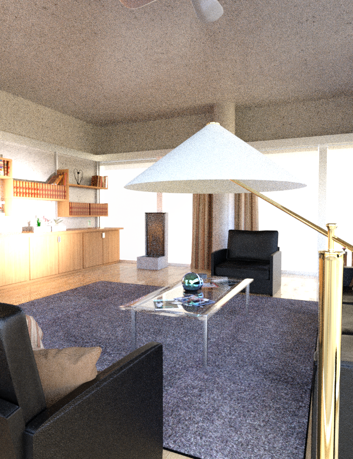

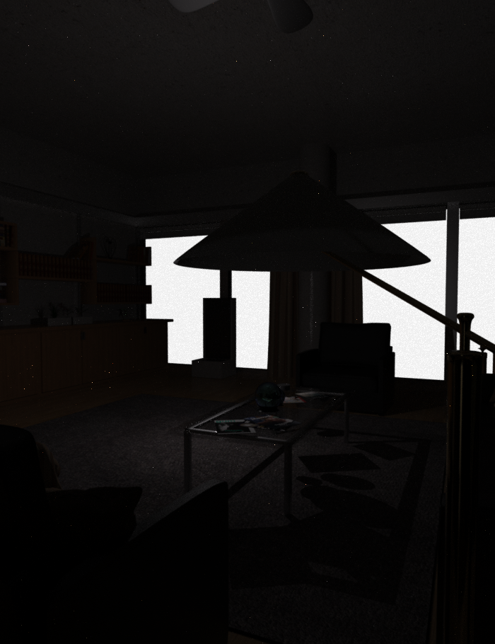

    Also, here's the same scene, with CM^2 set to 1,000 and environment intensity at .01, with and without a default spotlight pointed at the wall.

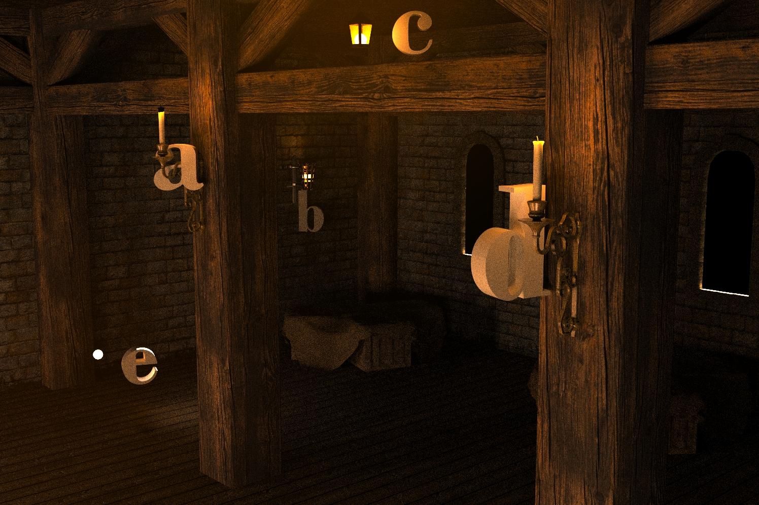

    I have been surrounded by photography for nearly seventy years, between my dad and myself, and use the settings in Tone Mapping all the time to set up the Environment for a render. For Emissive lighting I use cd/cm2 which means I can use lower settings than those recommended on the forums. I find using that setting with the recommended lumen for the type of light works, for me. When using a photograph that I have taken myself as a Background I use the Exif data to set the camera up and the Latitude/Longitude, time of day etc to set the Environment Dome. The camera I turn to face the direction that I was facing at the time e.g. North, South, East or West, or anything in between :)
    It works as in this image.
    Click on image for full size.
    I came across this render I did a long time ago when I was trying out bloom settings and I had taken a note of the lights and settings.
    Point Light 1 (Portal Light window first wooden upright)
    Linear Point Light (Portal Light window second upright near camera)
    Distant Light 150000.0 Lumens shining through windows.
    Spotlight on wall 1500 Lumens (E)
    Linear Pointlight 2 on ceiling 4500 Lumens (C) I think)
    Pointlight 2 on wall 5500 Lumens
