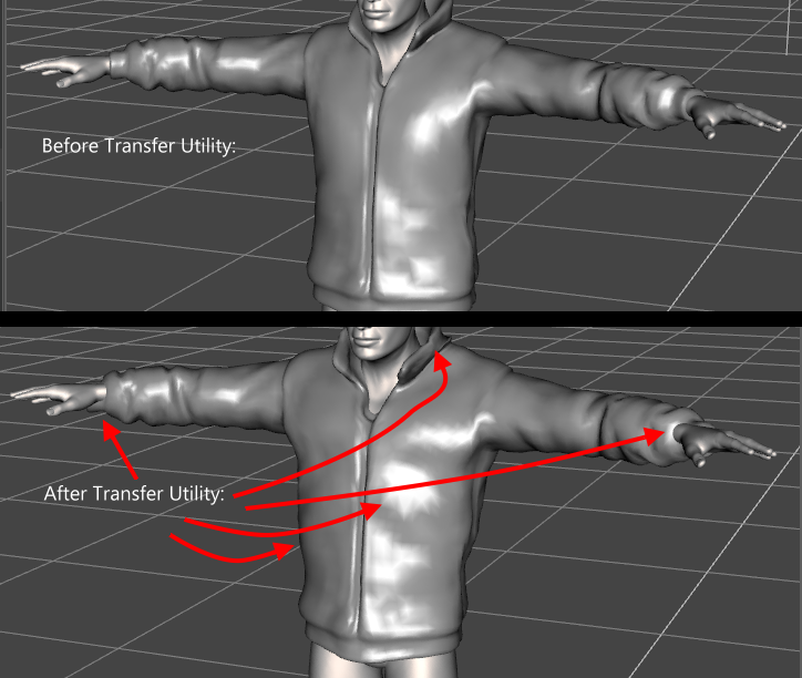

I have imported a jacket as an OBJ.
I want to turn this OBJ into a cloth that conforms and moves along with my Genesis 2 Female model. The Genesis 2 Female model has a full body morph.
When I use the "Transfer Utility" with the default settings, I get a jacket that conforms and moves along with the model.
However, the Transfer Utility fits the jacket to the model's morph. I don't like how the Transfer Utility does this, it doesn't look nice.
In fact, I would simply like to avoid the fitting. The transfer utility should just use what I give it.
So to do that, I un-check the Post Transfer Option "Fit To Source Figure".
But when I un-check this option, the Transfer Utility doesn't seem to do anything:

  • I don't think this is the Transferr Utility, I think it's the projected morph you don't like. You can block morph projection for a specific morph by giving the garment an empty property of the same name, or you can use a Rigidity group containimg the whole mesh to block all morph projection.

    First you need the name (not label) of the morph you want to block - you can get that by clicking the gear icon onits slider, selecting Parameter Settings, and copying the Name field.
    Now on the clothing item, which should not yet have been fitted to the figure, right-click in the Parameters pane and check Edit Mode (if it isn't already checked), then right-click and Create New Property, enter the copied name, and probably check Hidden (you don't want the do-nothing slider cluttering the property list). That should stop DS from geenrating an auto-follow morph, as it will see there is already a property with the name on the clothing.

    1. Load the jacket OBJ
    2. Run the Transfer utility but don't fit to the figure (or after fitting Fit to None, then use Edit>Figure>Clear Generated Morphs
    3. Get the name of the morph(s) you want to block - the exact name of the actual morph, not the label, not the name of a controller
    4. Create the new property and give it the name of the morph you want to block (create additional proeprties for additonal morphs if more than one have to be blocked)
    5. Now fit the jacket to the figure.
    How well it will work with such a radical reshaping of the mesh I don't know.

    I got it!! Your instructions were great, but one important note was missing:
    In my case, the morph name was "aval".
    So what I did was to create an empty parameter named "aval".
    Then I did the Transfer Utility thing.
    And NOW have a look at the parameter "aval".
    DAZ turned it up to 100%.
    So you may actually NOT hide it.
    Now turn "aval" down to 0%, and all the projections are gone, and the cloth conforms nicely.
    Thank you!!!

    Well, I was saying create the empty morph after the transfer - the not-fitting was to avoid the auto-generated morph getting in the way of creating the do-nothing version.
  • Hmmmm. I'm happy because how I understood your version works perfectly fine for me.
    The only thing I have to remember is that after Transfer Utility, DAZ unchecks the "Show hidden properties" for the Parameters pane, and I have to re-activate it in order to see my morph and to be able to disable it.
