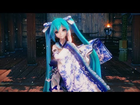

    So I just came across another video that demonstrates the kinds of things I would like to be able to do in DS. I have the DOJO and playground stages used in the video that can be brought in to DS via OBJ. I have the animated dust particles by  "The Philosipher,  and a script called pedal dropper that can do the effects seen on the outside. The lighting, skydomes DOF can already be done in DS. I also have a script by butaixianran that can bring the camera motion from MMD into DS. I will try to do this scene to see how it turns out, but would love some suggestions if anyone can see how to acheive something like this in DAZ. In fact links to all the assets used are on this YT page.
    https://www.youtube.com/watch?v=uFjfXwVM4j4
