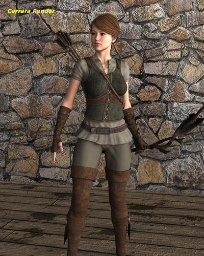

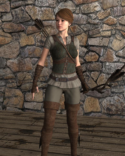

    For those who might be interested, attached are two images I did just to get a crude speed comparison between Carrara and Octane (using the DS plugin for Octane). To make a "fair" comparison I used the same scene in Octane and Carrara, with the default mats/shaders, and an HDR for lighting. To make it a close comparison I basically used max settings in Carrara (except no dof, and I didn't turn improved edges on), since that is what Octane is doing. Of course both images could be much better, but this was really just a test, and I wasn't trying to get the best image possible. Both images were rendered at 1200x1500, the images posted here are reduced to 960x1200. I forgot to use dof with the Carrara render - so you can add a bit more to the final render if ray traced dof was enabled.
    I let the Octane render go to 2000 samples per pixel, and it took just about 15 min. using path tracing and the final render setting. The Carrara image took 2hrs. 17min. Of course I could change a few settings, use a light dome for fake GI, or even just use a 3 point light set up and probably get very close to the Octane render time and shave a great image, but that would defeat the purpose of the test a bit. Still, I think that a little over 2 hours really is't bad at all for Carrara, I'm sure Lux would take a lot longer.
    What I really like about Octane is the nearly instant feedback you when you change lighting, shaders, etc. Another thing I really like about using Octane is my system (laptop) runs a lot cooler rendering with Octane than with CPU rendering. I'm definitely going to get the Carrara plugin, because it will be a great addition to my Carrara tool-set, but I'm pretty sure Carrara's internal renderer will still get a lot of use!

    Interesting comparison and two very nice looking renders.
  • Jay_NOLAJay_NOLA Posts: 1,145
    Very interesting comparison.
    It looks like IMHO that Carrara renders some stuff better in the image than Octane and Octane Renders some other things better than Carrara.
    I wounder how things would look if a Carrara render of only the things only the things Carrara renders better were to be combined in post with an Octane render of just the things Octane renders better.

    Jay_NOLA wrote “It looks like IMHO that Carrara renders some stuff better in the image than Octane and Octane Renders some other things better than Carrara”
    That’s exactly what I thought as well. I think a lot of that could be addressed by optimizing the shaders for each renderer. That’s one of the reasons I didn’t do any editing of the shaders, I wanted to see how the shader translations compare between the two. Of course the other reason is I didn’t want to show off my incompetent shader skills, and make things look even worse.
    I think this does demonstrate how good Carrara’s renderer is holding up, even without any major upgrades over the past few years. But, with the proper hardware configuration (i.e. a huge investment in video cards, like 4 GTX Titan cards), Octane is simply amazing. The video links below give you a good idea what can be done with multiple GPU’s.

    I'm dying to ask - did you use any gamma setting with the Carrara render?

    Here is another render from Carrara with "DOF" - sort of, to compare with the Octane version. I should have set it a bit higher - had it at 50%. I tried ray traced dof, but after an hour I still had an estimated 39 hours to go. So, that actually makes Octane even more impressive, because it uses ray traced dof, not z buffer based blur applied in post.
    Phil - no gamma used for the image, just a simple default settings Carrara render, using an HDRI that came with Octane.

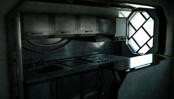

    Here we go.
    I'm taking baby steps here. Once you get past the "wow! I can do EVERYTHING right out the box" feeling (ha ha). The reality is that to do what you are used on Carrara requires a rethink.
    atm then although I'm learning about all these great lights, my renders are restricted to single sun light. However I post this as I've been playing about with renderers, cameras and light colouring.
    This is the well known Sci Fi Apartment. It's a great model to render with in Octane because it uses hardly any textures. It is heavily uv mapped.
    This took 20 mins or so to render. I know there are fireflies on there. I could get rid of them in an instant by choosing HDRI lighting, but the result is somewhat more realistic with the daylight light source.

    Very nice, Steve! After all the reading and video demos, I think I'm sold on this product now. I really like to work sequence used. I guess I'll download the demo this week.
