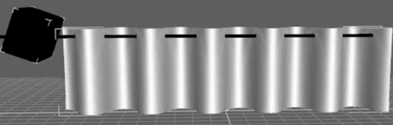

    Personally, I'd first go into a modelling software (I'd use Blender), add a plane, and subdivide it a bunch of times. Then shift-select alternating vertical lines of polygons, and using the falloff tool, move those polygons so that you form big wrinkles in the curtain. Then you can punch a hole thru the top wrinkles so that you can add a rod as a collision object for the simulation. After that, in Studio/VWD, you just use a force field or wind to push the curtain open, and it should slide along the rod (you'll probably have to stiffen the polygons surrounding the rod). Or I suppose you could animate an invisible collision object to push it open...

    Like I said you could animate an invisible collision object to pull the curtains open in VWD.

    I tried what ebergerly suggested , with the push object. Gif below
    A real curtain wouldn't compress quite as flat, folded over as much. There are hooks or rings that are interspaced which suspend the curtain, but they also provide spacing between each bend. In DS you might be able to paint a weight map alternating strong/weak strips to achieve that effect. Or maybe play with the cloth settings/stiffness, or add some wind or other modifiers. In other programs you could attach pins to geometry or hooks, just like a real curtain, and animate the hooks .
