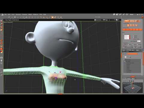

    a quck cripeman tut on morph targets
