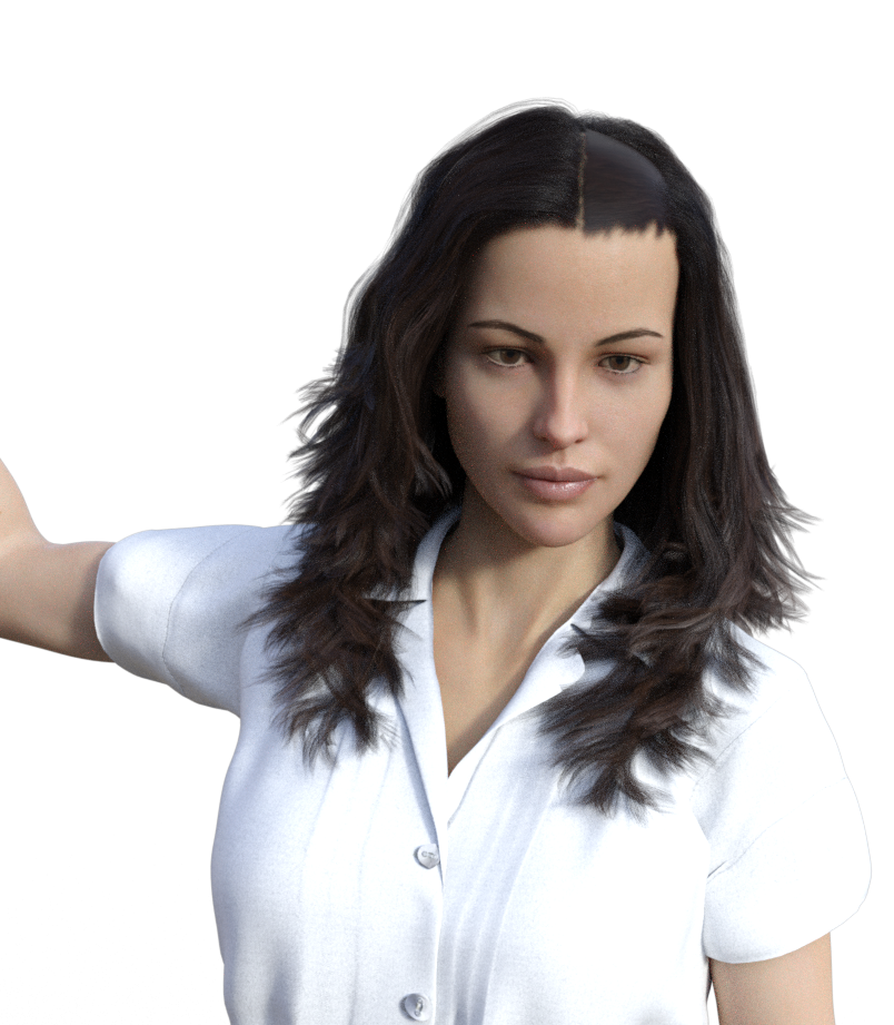

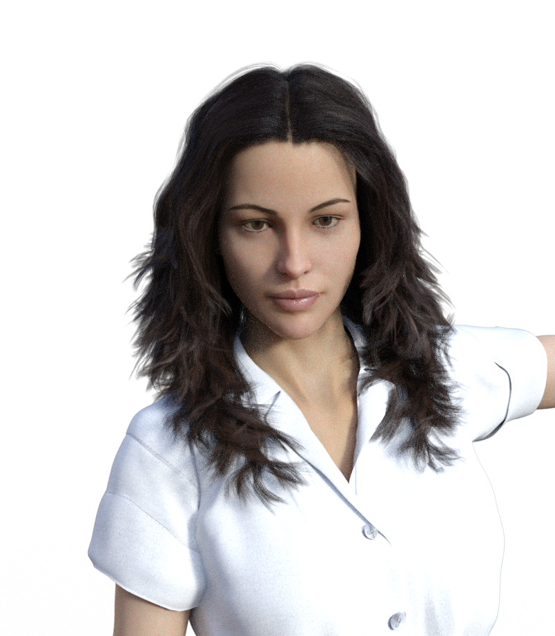

I have the Addison hair loaded on V8, but when I apply a certain pose, the hair gets distorted. The mirrored pose included works fine. Any idea what can be causing this?

  • Syrus_DanteSyrus_Dante Posts: 983
    I guess some JCM (Joint Controled Morph) is acting crazy.
    To check for JCMs I would unfit the hair, selecting Property Groups "All" in the Parameters pane and typing JCM in the Filter Box on top to see the list of JCMs that got projected from the genesis figure to the hair. Make shure to chack Show Hidden Properties in the Parameters pane Option Menu (the lined button on top of the pane).
    If the hair is "unfitted" you can now manualy turn up the JCMs, I would have a look at Right Collar JCMs first, by the looks of it I suspect one of these. If you found the culprit JCM delete it, don't worry a new propper one will propably get created by the time you fit the hair to the genesis figure again.
    Thanks very much, that fixed it.
    Actually it was the jJCMCollarFwd_L that did it. Not sure how to delete a JCM though so I tried deleting the bone for the affected hair part, and that worked. Later I found out that just changing the JCM dial from 0.76 to 0.00 while the hair is fitted to V8 works as well.
