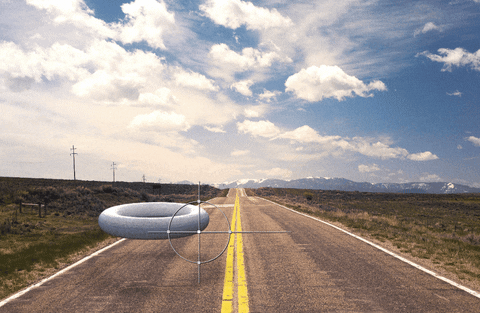

Okay, now it's working fine. Here's a demo showing a simple render over a background foto, including the shadows. I added a bit of environment light, plus most lighting from an overhead emissive plane, and did a Grade on the shadow/alpha channel to darken and lighten the shadow in realtime. And moved the image around a bit with a Transform.
