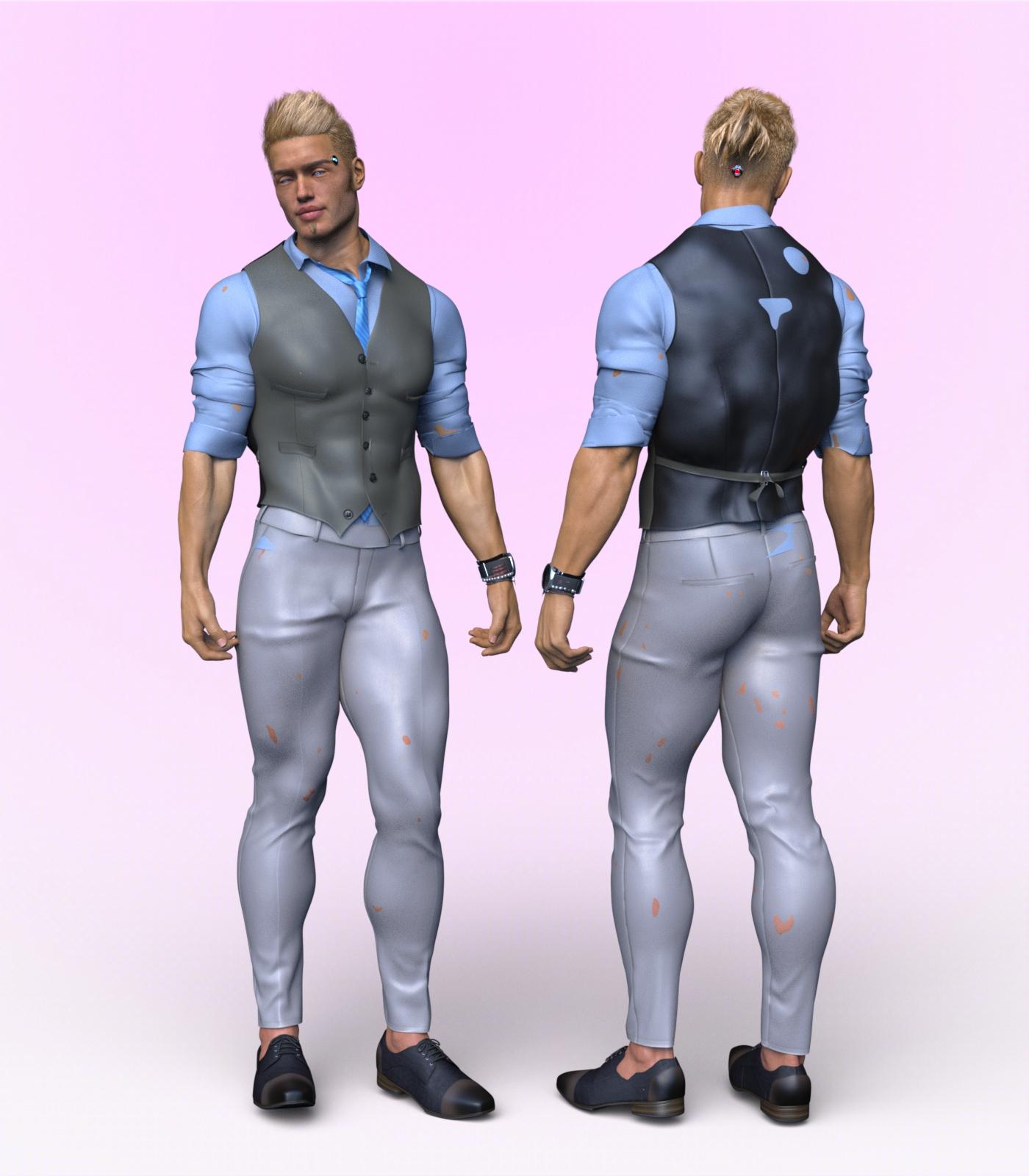

    Here's my example. This is just out of the box. Even the shoe doesn't fit properly. Usually- and I say usually, I can get base dforce outfits to fit the guys just fine. There may be one spot or two of pokethhrough but not many. The shoe which must be conforming doesn't even fit.
    This is disappointing because I don't want to really dforce this set. It already has baked in wrinkles.... I'm not sure I need more drape.

    What outfit is that in your example?
  • Serene NightSerene Night Posts: 17,704
    https://www.daz3d.com/dforce-oxford-outfit-for-genesis-8-males

    Maybe Elios will look like Timothee Chalamet... anyway, with that much pokethrough to start with, I'd imagine every simulation would fail. I expect that clothing meant for dforce might look stiff, flat, or stick out from the figure, the examples post just look like they don't fit sadly... frown Unfortunately I don't have this to try myself, though I had set aside the item to purchase soon... if you start out expanding each item so they are well clear of any pokethrough, can you get it to simulate without the error message? (Along with having the hair be invisible in simulation)
    Removing the hair didn't produce any reduction of pokethrough, but I did it anyway. I enlarged the pants and vest, and although the vest now sticks up from the shoulder the look is really quite close to the base clothing fit without dforce. The crotch just is more defalted and the shoulders are higher.
    Try fitting the vest onto the shirt
    What might (!) help a bit:
    - use timeline for simulation
    - enlarge the clothing to 105% (or so..) to keep it from being in contact with the figure
    - in the surfaces tab of the clothing item look for "Contraction-Expansion Ratio" and set it to 95%
    - then run simulation
    The setting should shrink the clothing at the start of the simulation, which should keep that vest from "floating" above the shoulders.
    And it also often helps to not simulate the whole outfit together, but to simulate each part for itself with the "Freeze Simulation" setting in the Parameters tab set to "On" for all other parts.
